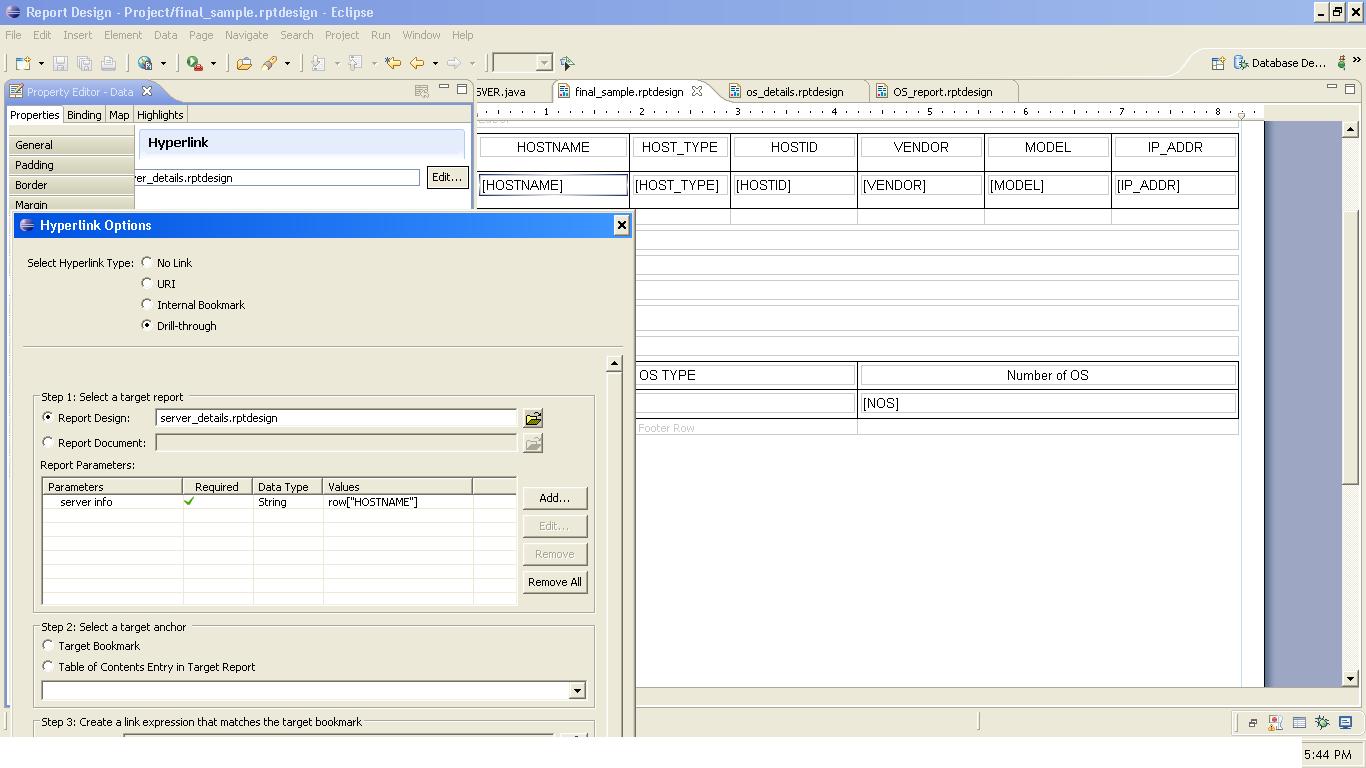

I want to use drilldown option using java api program, but i am not able to do it.
Please help me in this regard.
Thanks in advance.

Re: Drill Through (Hyperlinks) is not working in remote server [message #842270 is a reply to message #841693] Thu, 12 April 2012 02:21 Go to previous messageGo to next message
I have written java class in which i have to implement drilldown option programatically. I run java program through command line.

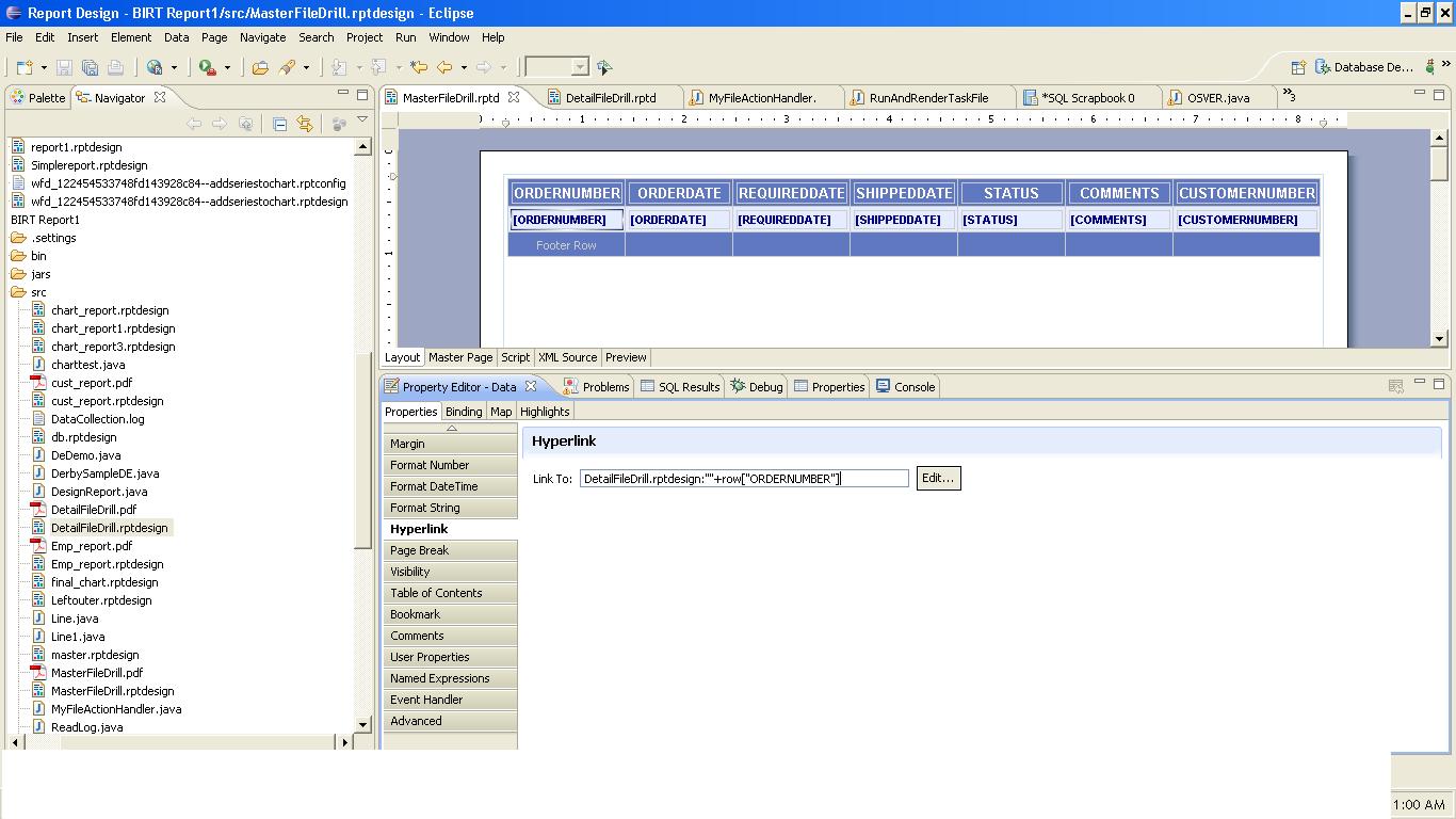

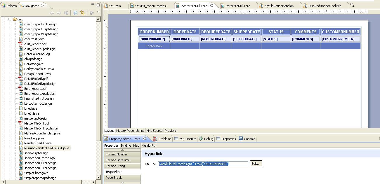

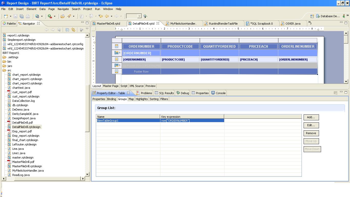

Re: Drill Through (Hyperlinks) is not working in remote server [message #850580 is a reply to message #842759] Fri, 20 April 2012 02:38 Go to previous messageGo to next message
I have designed rpt design file by implementing drill down feature. I have called that rpt design file in java program using birt api program.
I am getting exception like "java.lang.IllegalStateException: Unable to determine the default workspace location. Check your OSGi-less platform configuration of the plugin or datatools workspace path.
at org.eclipse.datatools.connectivity.internal.ConnectivityPlugin.getDefaultStateLocation(ConnectivityPlugin.java:154)".
I have uploaded java api program and rpt design files. plz verify this.
Re: Drill Through (Hyperlinks) is not working in remote server [message #850701 is a reply to message #850580] Fri, 20 April 2012 04:48 Go to previous messageGo to next message

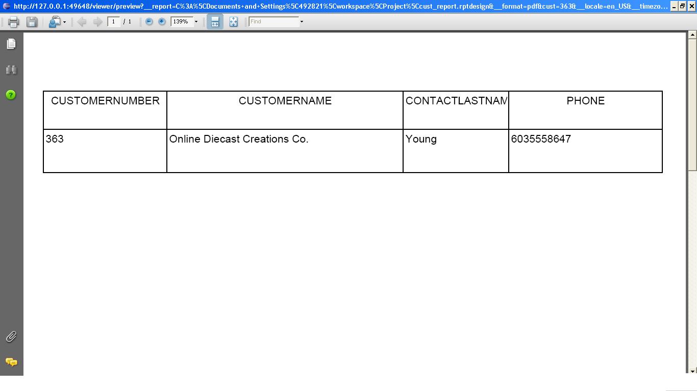

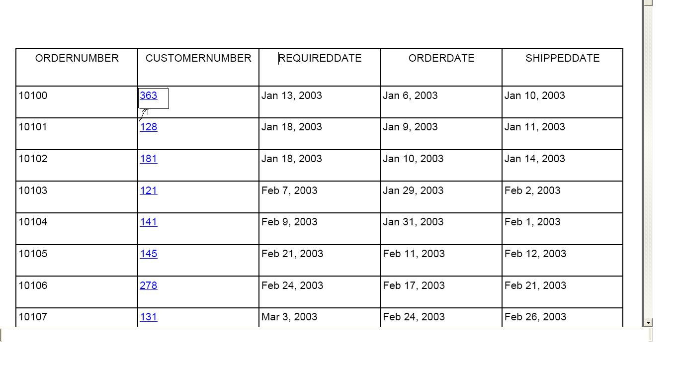

Re: Drill Through (Hyperlinks) is not working in remote server [message #857201 is a reply to message #856390] Thu, 26 April 2012 06:35 Go to previous messageGo to next message
Hi Jason,
Thanks for the above reply. I have one more query. In the uploaded image I am creating hyperlink of Drill through option using UI. Can we create this Drill through option using java program? I want to create everything using java program without doing in UI. Please help me on this.
Priyanka
Re: Drill Through (Hyperlinks) is not working in remote server [message #857675 is a reply to message #857201] Thu, 26 April 2012 15:07 Go to previous messageGo to next message
The issue with this drill is that you are trying to link to run the
detail report on the fly. I am not certain how that can be done with a
url. In the action handler you have full access to the url that is
created. You may be able to create a bat file that runs the engine and
call it, but I am not certain how to do this.
Jason
On 4/26/2012 6:35 AM, devi priyanka wrote:
> Hi Jason,
> Thanks,

Re: Drill Through (Hyperlinks) is not working in remote server [message #858441 is a reply to message #857675] Fri, 27 April 2012 02:08 Go to previous messageGo to next message
Hi Jason,
Please give me solution for below mentioned queries:
1) I have edited rptdesign file through API and creating data source , data set and binding data set to table using java program. PFA for image file named "Master.jpeg" and please let me know how to set Hyperlink property using java api.
2) In the other attached rpt design file i.e "Detail.jpeg" shown, in that i want to set grouping through java program.
Thanks in advance
Priyanka

Re: Drill Through (Hyperlinks) is not working in remote server [message #859931 is a reply to message #858441] Fri, 27 April 2012 17:45 Go to previous messageGo to next message
Try
DataItemHandle data = designFactory.newDataItem( "data1" );
Action ac = structFactory.createAction();
ActionHandle actionHandle = data.setAction( ac );
actionHandle.setLinkType(DesignChoiceConstants.ACTION_LINK_TYPE_DRILL_THROUGH);
actionHandle.setReportName("DetailFileDrill.rptdesign");
actionHandle.setTargetFileType("report-design");
actionHandle.setTargetBookmark("\"\"+row[\"ORDERNUMBER\"]");
actionHandle.setTargetBookmarkType("bookmark");
actionHandle.setTargetWindow("_blank");
actionHandle.setFormatType("pdf");
For table and group look at this snippet:
TableHandle table = elementFactory.newTableItem( null, 3, 1, 1, 1 );
table.setProperty( StyleHandle.TEXT_ALIGN_PROP,
DesignChoiceConstants.TEXT_ALIGN_CENTER );
table.setWidth( "80%" );//$NON-NLS-1$
table.setProperty( TableHandle.DATA_SET_PROP, "Data Set" );//$NON-NLS-1$
PropertyHandle computedSet = table.getColumnBindings( );
cs1.setExpression( "dataSetRow[\"Month\"]" );//$NON-NLS-1$
computedSet.addItem( cs1 );
cs2.setExpression( "dataSetRow[\"Product\"]" );//$NON-NLS-1$
computedSet.addItem( cs2 );
cs3.setExpression( "dataSetRow[\"Amount\"]" );//$NON-NLS-1$
computedSet.addItem( cs3 );
// Table sorter
SortKey key = StructureFactory.createSortKey( );
key.setKey( "row[\"Month\"]" );//$NON-NLS-1$
key.setDirection( "asc" );//$NON-NLS-1$
PropertyHandle sort = table.getPropertyHandle( TableHandle.SORT_PROP );
sort.addItem( key );
// Header
RowHandle header = (RowHandle) table.getHeader( ).get( 0 );
CellHandle tcell = (CellHandle) header.getCells( ).get( 0 );
LabelHandle label = elementFactory.newLabel( null );
label.setText( "Product" );//$NON-NLS-1$
label.setStyleName( "Label" );//$NON-NLS-1$
tcell.getContent( ).add( label );
tcell = (CellHandle) header.getCells( ).get( 1 );
label.setText( "Month" );//$NON-NLS-1$
tcell = (CellHandle) header.getCells( ).get( 2 );
label.setText( "Amount" );//$NON-NLS-1$
// Table Group
TableGroupHandle group = elementFactory.newTableGroup( );
group.setKeyExpr( "row[\"Product\"]" );//$NON-NLS-1$
table.getGroups( ).add( group );
RowHandle groupHeader = elementFactory.newTableRow( 3 );
tcell = (CellHandle) groupHeader.getCells( ).get( 0 );
tcell.setDrop( DesignChoiceConstants.DROP_TYPE_DETAIL );
DataItemHandle data = elementFactory.newDataItem( null );
data.setStyleName( "Data" );//$NON-NLS-1$
data.setResultSetColumn( cs2.getName( ) );
tcell.getContent( ).add( data );
group.getHeader( ).add( groupHeader );

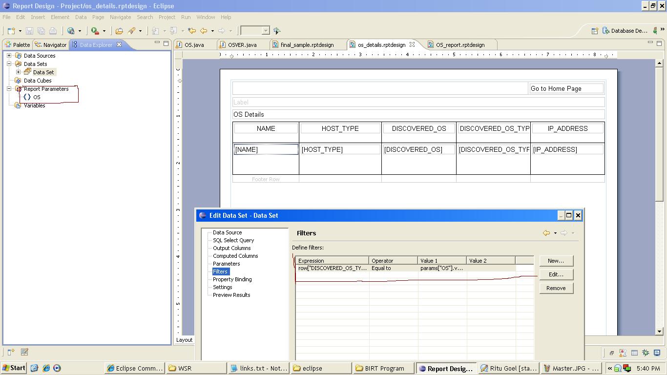

Re: Drill Through (Hyperlinks) is not working in remote server [message #868698 is a reply to message #859931] Wed, 02 May 2012 08:23 Go to previous messageGo to next message
Hi Jason,
Thanks for the above reply. It helped me a lot. Please give solutions for below queries.
I want to do this using java program.
1) In the Master.jpeg, i want to implement Drill through option using report parameters in java birt api program.
2) In the Detail.jpeg, as shown in the image i have to create report parameter, and also add filter to the same rptdesign file using java birt api program
Thanks in Advance
Priyanka

Re: Drill Through (Hyperlinks) is not working in remote server [message #869671 is a reply to message #868698] Thu, 03 May 2012 11:34 Go to previous messageGo to next message
On one once you create the drill through you can add the parameter like:
List<Expression> expressions = new ArrayList<Expression>( );
Expression expr = new Expression("row[\"ORDERNUMBER\"]",
ExpressionType.JAVASCRIPT);
expressions.add(expr);
actionHandle.getMember("paramBindings");
ParamBinding pb = StructureFactory.createParamBinding();
pb.setParamName("order");
pb.setExpression(expressions);
actionHandle.addParamBinding(pb);
