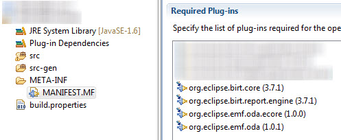

Since I'm using the EMF ODA driver, the 'value' in this example is of the type 'org.eclipse.emf.oda.ecore.impl.ResultSet.JavaObject'. Logical step for me is to add the required plug-in (org.eclipse.emf.oda.ecore) as a dependency, so I have the required classes in my class path.
index.php/fa/6313/0/
Now to my problem: When running my report (in designer/preview mode) with this handler and the two lines below, I get a ClassCastException for 'JavaObject'.

This looks like it may be a bug. Where did you add the dependency?
It may have to be added to the report engine plugin.

Jason,
Thanks for your answer.
My problems were fixed after adding the report engine plugin to my workspace and adding the required dependencies there. Thanks!
