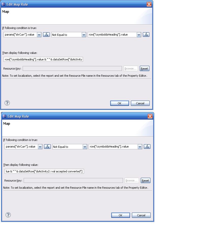

Thanks dpardon for your info.
What exactly I am trying to do is shown in the picture.
If the value from the parameter (params["strCurr"].value) is the same like in the field (row["csymboldsHeading"].value) than leave the data field empty.
But, if the value from the parameter (params["strCurr"].value) is the same like in the field (row["csymboldsHeading"].value) than show the data from two fields formated together (row["csymboldsHeading"].value & " " & dataSetRow["dsActivity2::val accepted converted"].value). So the compare is done with a field in one data set and after evaluation I want either to show no data, leave it blank, or show data from another data set.
I know of Joined Data Sets, but I can't join these two sets since data is quite different.
Is this possible? Some other way to do it?
Thanks!
P.S. Picture shows the same MAP twice, so you can see the full text of the "Then display following value:" box.

Re: Translating from Reorting Services to BIRT [message #764600 is a reply to message #763203] Mon, 12 December 2011 09:00 Go to previous messageGo to next message
What am I doing wrong? Can somebody point me to the right direction? I don't have experience in Java Script, but I am looking at scripting for a data object and trying to make it look like this but I am not sure if scripting can (if not, please let me know what can be used in order to have this valuation and presentation possible):
if(Parameters!Name.Value = Field1FromTable1.Value, DataSet1)
Show nothing,
ELSE Show ("Field1FromTable1.Value, DataSet2" + "Field2FromTable1.Value, DataSet2")
Your help is much appreciated.

Re: Translating from Reorting Services to BIRT [message #765613 is a reply to message #764706] Wed, 14 December 2011 06:37 Go to previous message
It wasn't exactly what I needed, but it pointed me to the right direction.
Thank you Jason once again!
