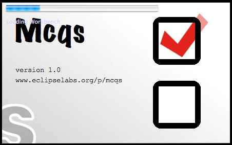

The SWT splash screen has now a progress bar and some text explaining which plug-in is loading. The layout do not see good:
index.php/fa/9640/0/

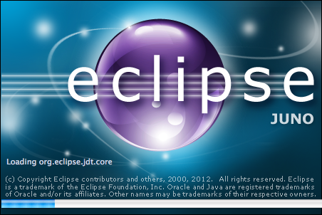

There are probably some possibilities to configure the layout. By comparison on the Juno Splash screen, the progress bar is at the bottom and takes all the window width. The text is over the progress bar.
