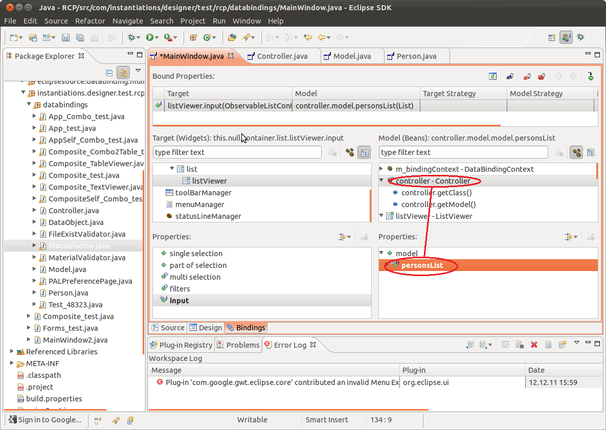

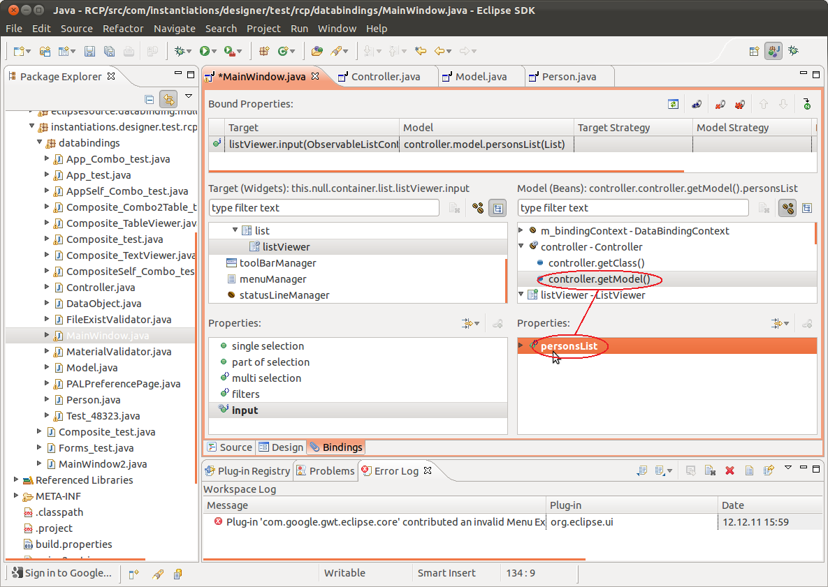

Re: Binding through several instances? [message #764591 is a reply to message #759633] Mon, 12 December 2011 08:45 Go to previous message
BeansObservables not allowed using dot-separeter property names for observe lists, sets and maps (its allowed only for observe single values).
Using followed template is INCORRECT:
Target (Widget) = listViewer, input
Model (Bean) = controller, model>personList
index.php/fa/6437/0/
CORRECT template to use is:
Model (Bean) = controller>model, personList
index.php/fa/6436/0/
PS Trunk fixed for disabling button "Create binding" for incorrect template.
