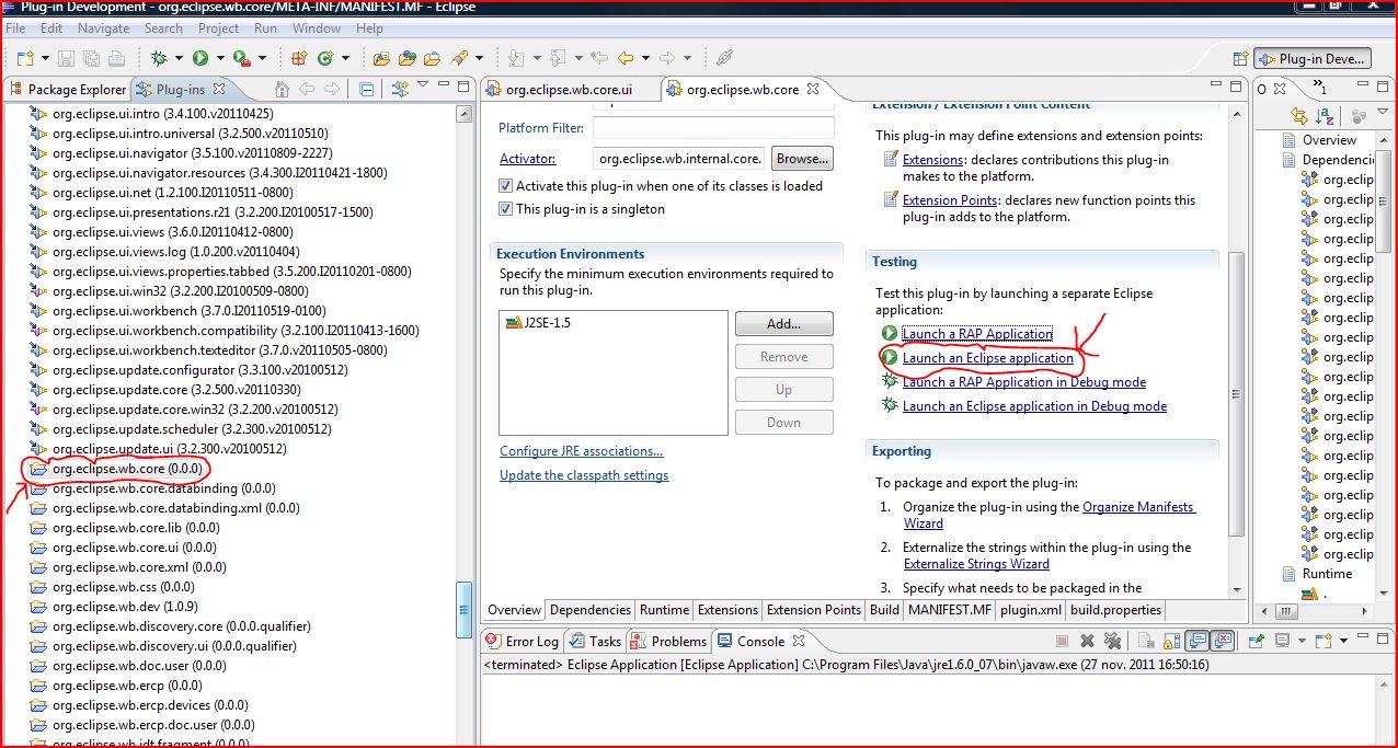

To answer me, when all projects are imported in Eclipse, go to Plug-ins view, then choose org.eclipse.wb.core and then click in Launch an Eclipse application (i-e Capturer.JPG)

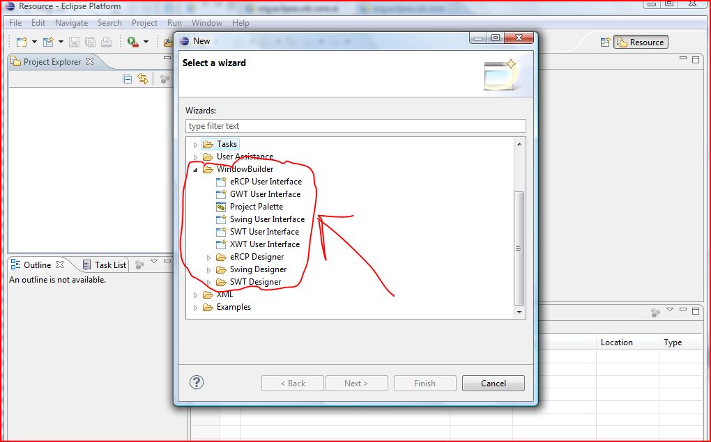

Then in the new Eclipse launched you can find WindowBuilder options when creating a new project (i-e Capturer2.JPG)

  • Attachment: Capturer.JPG
    (Size: 230.07KB, Downloaded 336 times)
  • Attachment: Capturer2.JPG
    (Size: 93.23KB, Downloaded 316 times)
