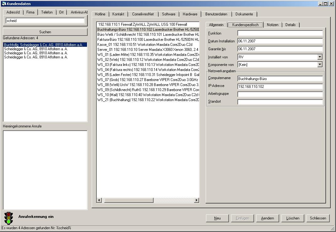

My application is a hotline tool, where the parent sash contains on the left a component with filtered customers listed, while on the right a huge amount of detailed information about the selected customer ist shown. This information is organized hierarchically, the right part of the sash has several PartStacks, each of them has a sash, which shows a list in the right (or top) part and likely another partStack containing sashes for more detailed information.
The attached image shows an example: a sash with a partstack on the right containing several parts (Hotline, Kontakt, ComelivresNet, Software, Hardware, Benutzerdaten, Dokumente), showing currently the part Hardware, which in turn contains of a sash with a list (of Hardware) on the left and a partstack to the right with parts (Allgemein, Kundenspezifisch, Notizen, Details). Each of them could contain another sash AND SO ON...
I hope this is clear enough to understand. What do you thing about that?
Thank you!
> Thank you!

Hi Tom,
to be precisely:
I have an application.e4xmi which contains of a perspective with a partsashcontainer, which in turn contains a sashcontainer and a partstack with id "ch.eugster.ims.hotline.details".
In another plugin I have a fragment.e4xmi, where I added a "String Model Fragment" with the element id "ch.eugster.ims.hotline.details", Featurename "children" and an element PartSashContainer.
The whole I stuck together with the "e4 Workbenchmodel Editor".
Because my domain model has a somewhat deep hierarchy I would like to use PartSashContainers within PartStacks. The UI would be nicer and more userfriendly, than if I used e.g. master detail blocks.
Christian
