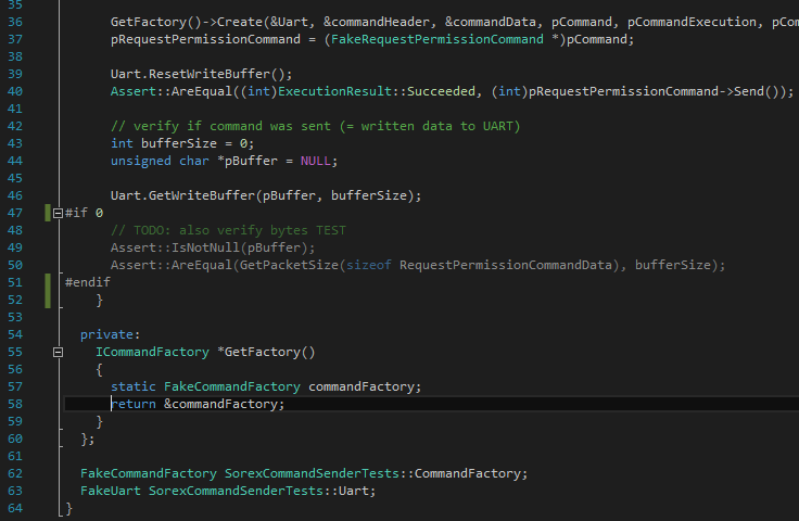

Re: How do I change highlighting of C++ preprocessor directives? [message #1727472 is a reply to message #764817] Wed, 23 March 2016 05:53 Go to previous messageGo to next message
Exists there a way to just "gray-out" disabled code like VS?
