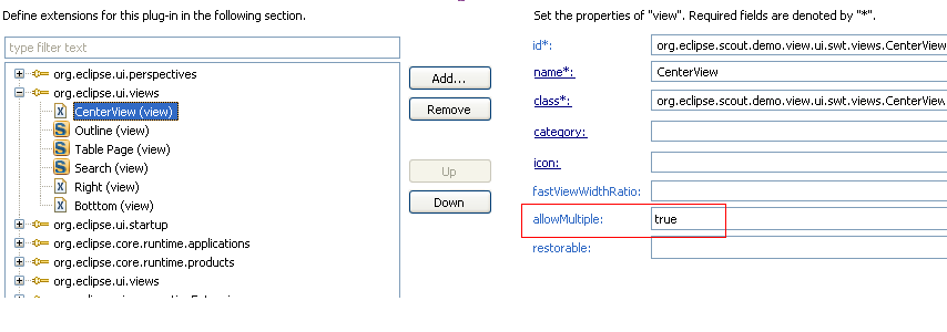

Try setting allowMultiple at your view to true. This makes sure a secondaryViewId is generated in order to distinguish the views. This should solve your problem.
Now if you want to open/activate the same view when the same record is selected you have modify your ZinnenForm a little. You need to start your form in exclusive mode and compute an exclusive key (typically the primary key of your entity) which distinguishes the records.
