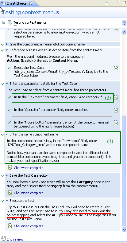

Yes, I've tried that, and let me clarify this.
The cheatsheet itself says that, "You may also need to carry out the object mapping ...", as shown below.
index.php/fa/6183/0/
So, correct me if I'm wrong because, it looks like you DOES NEED object mapping for using the context menu BUT, this is not the point.
My point is that, even though it needs object mapping, I tried it, and it works fine for testing Swing app but, it does not work for testing RCP app
because, jubula does not reconize RCP context menu.
Now, if you try it yourself with Eclipse(any version) or another RCP apps, you will see what I mean. (which, to me it looks like a bug)
Nack
Re: Problem Mapping Context Menu in RCP [message #757659 is a reply to message #757646] Mon, 21 November 2011 03:06 Go to previous messageGo to next message
Good morning Nack,
The way the context menu actions work is as follows:
- You enter the component name for the component on which the context menu will be opened (in the case of the cheat sheets project, the "DVDTool_Category_tree"). I've shown this step in the picture you uploaded as (1).
- This basically just tells us on which component to open the context menu. The navigation through the menu is done by path: we do not need to map individual nodes (as I explained in the second post above). The fact that individual items are recognizable as buttons in Swing is pure chance. As with main menus, we navigate through the context menu using the path to the item (which is much more robust than mapping individual entries anyway). In the case of the cheat sheet, this is "Add category.*" (marked with (2) on the picture).
- The reason you may need to carry out object mapping in the example is if you have used a different component name for the tree than the one which is already mapped for the project.
index.php/fa/6184/0/
Hope this helps,
Alex
