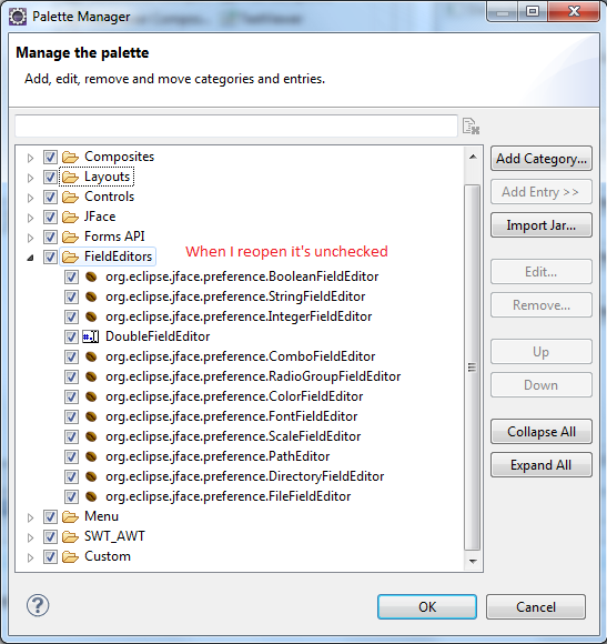

I have a problem when trying to include FieldEditors in my Palette.
I open Palette Manager, check FieldEditors, press OK.
But it doesn't appear in the Palette.
When I reopen Palette Manager again, FieldEditors is unchecked (I attached image)
If this info means something : I can make it form code
fileFldEditor = new FileFieldEditor(...
ant it appears correctly, as far as I can see.
I guess it's something trivial, but I can't figure it out.
Thanks in advance

Component on palette ins displayed only if its Class in present in ClassLoder.
So, if you create just SWT application, without Eclipse UI plugins, you don't have them.
Create Eclipse plug-in instead, and say that you want contribute to UI, when wizard will ask you.

Also keep in mind that the Field Editor palette will only appear, if you are editing a Field Editor Preference Page.

You should create an Eclipse RCP or plugin project and then create a new a Field Editor Preference Page. Only then will you see the Field Editor palette (palette categories are context sensitive and Field Editors have a very limited use).

I've tried what Eric said but I can't make it appear. I'm probably making some beginner mistake, but I can't figure it out.

A test case and a screen shot of what you are seeing would be useful here.
