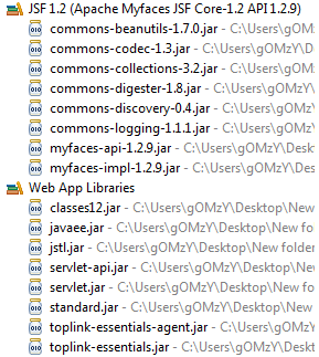

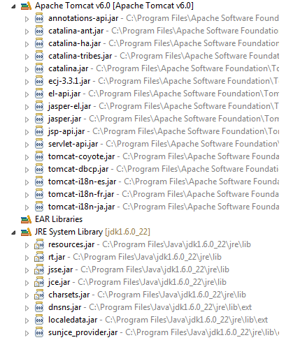

I believe that you can help me out sir, nobody even replied to my thread at least which you did Smile
Please have a look at the attachments displaying the jars i am using. i am sure there is some version problem with the jars which i am unable to sort out.
index.php/fa/6045/0/
index.php/fa/6046/0/
index.php/fa/6047/0/
Please provide some useful suggestions, i am breaking my head since last few days for this. When i run the page, the jsf tags are not getting rendered, but i am not getting any exception in my console as well.
butny

Re: UnsupportedOperationException [message #755173 is a reply to message #755171] Mon, 07 November 2011 10:36 Go to previous messageGo to next message
index.php/fa/6048/0/
  • Attachment: 1.png
    (Size: 25.48KB, Downloaded 5762 times)
Re: UnsupportedOperationException [message #755175 is a reply to message #755173] Mon, 07 November 2011 10:38 Go to previous messageGo to next message
index.php/fa/6049/0/
Please provide your suggestion by having a look at the three attachments.

My suggestion is to abandon MyFaces in favor of RichFaces. Use the
following articles to guide your work and pay especially close attention
to the libraries used:
http://www.javahotchocolate.com/tutorials/wtp-jsf.html (makes use of
another author's tutorial)
http://www.javahotchocolate.com/tutorials/richfaces.html
At the end of the article, there's a list of JAR downloads. What's

Re: UnsupportedOperationException [message #755383 is a reply to message #755171] Tue, 08 November 2011 05:28 Go to previous messageGo to next message
Hi Butny,
which server do you use? I assume it is a Tomcat? For the list of
included JARs: it is always a problem to bundle JARs which are already
part of your server.
I suggest to remove e.g. "servlet-api.jar" from your "lib" directory.
Don't bundle things which can be found e.g. in "common\lib" of your
tomcat installation. They can cause conflicts.
I am not sure whether tomcat already bundles a JSF implemention, but I
assume you have to deploy a jsf implementation as part of your app.
Do you have a "faces-config.xml" in your project?
Do you include the FacesServlet in "web.xml"?
<servlet>
<servlet-name>Faces Servlet</servlet-name>
<servlet-class>javax.faces.webapp.FacesServlet</servlet-class>
<load-on-startup>1</load-on-startup>
</servlet>
<servlet-mapping>
<url-pattern>*.faces</url-pattern>
</servlet-mapping>
Your jsp pages have to contain a "taglib" for the JSF libraries - e.g.
like this:
<?xml version="1.0" encoding="ISO-8859-1" ?>
<%@ page language="java" contentType="text/html; charset=ISO-8859-1"
pageEncoding="ISO-8859-1"%>
<%@ taglib uri="http://java.sun.com/jsf/html" prefix="h" %>
<%@ taglib uri="http://java.sun.com/jsf/core" prefix="f" %>
And finally? How do you call your JSF? Don't make a call to
"mypage.jsp", but use the extension you decalred in web.xml, e.g.
"mypage.faces" => this will be redirected to your JSP.
Hope this helps
Wolfgang
Am 07.11.2011 16:35, schrieb butny:
> Hi,
> I believe that you can help me out sir, nobody even replied to my thread at least which you did :)
> Thanks,
> butny
Re: UnsupportedOperationException [message #755461 is a reply to message #755383] Tue, 08 November 2011 10:21 Go to previous messageGo to next message
I removed the servlet-api.jar, had to add the jstl-api and jstl-impl jars in a new user library named "JSTL" and it works fine for me, hence i can say that it was a jar collision. But thats only one part of the story, may be the begining of a new one. I was using two eclipse versions parallely for checking if there is some problem with my eclipse or not. Now the setup is working fine in Indigo but the same thing is not working Helios. Still in Helios, the jsf tags are not getting rendered. I am surprised about this.
The only difference i can see between the helios and indigo one is that in indigo, there is the use of @taglib as Wolfgang showed whereas in helios, this is used:
<!DOCTYPE html PUBLIC "-//W3C//DTD XHTML 1.0 Transitional//EN" "http://www.w3.org/TR/xhtml1/DTD/xhtml1-transitional.dtd">
<html xmlns="http://www.w3.org/1999/xhtml"
	xmlns:f="http://java.sun.com/jsf/core"
	xmlns:h="http://java.sun.com/jsf/html">
May be i am missing something in helios which is causing me not to render the jsf tags when the page is run Sad
Please provide your suggestions on how to run the helios "hello world" jsf project.

Your ideas really worked like you said about the jar collision (i.e, servlet-api.jar). But i need to ask you a question which i cant understand in your reply.
Q. My url-pattern in web.xml is like this: /faces/*
If i change it to the one you mentioned then what are th advantagges/disadvantages i am going to face? again, if i change it to the one you mentioned, then how to create a file with an extension of .faces? I cant see any option in my ide to create a file with extension of .faces Sad Please inform how to do it.
Butny
