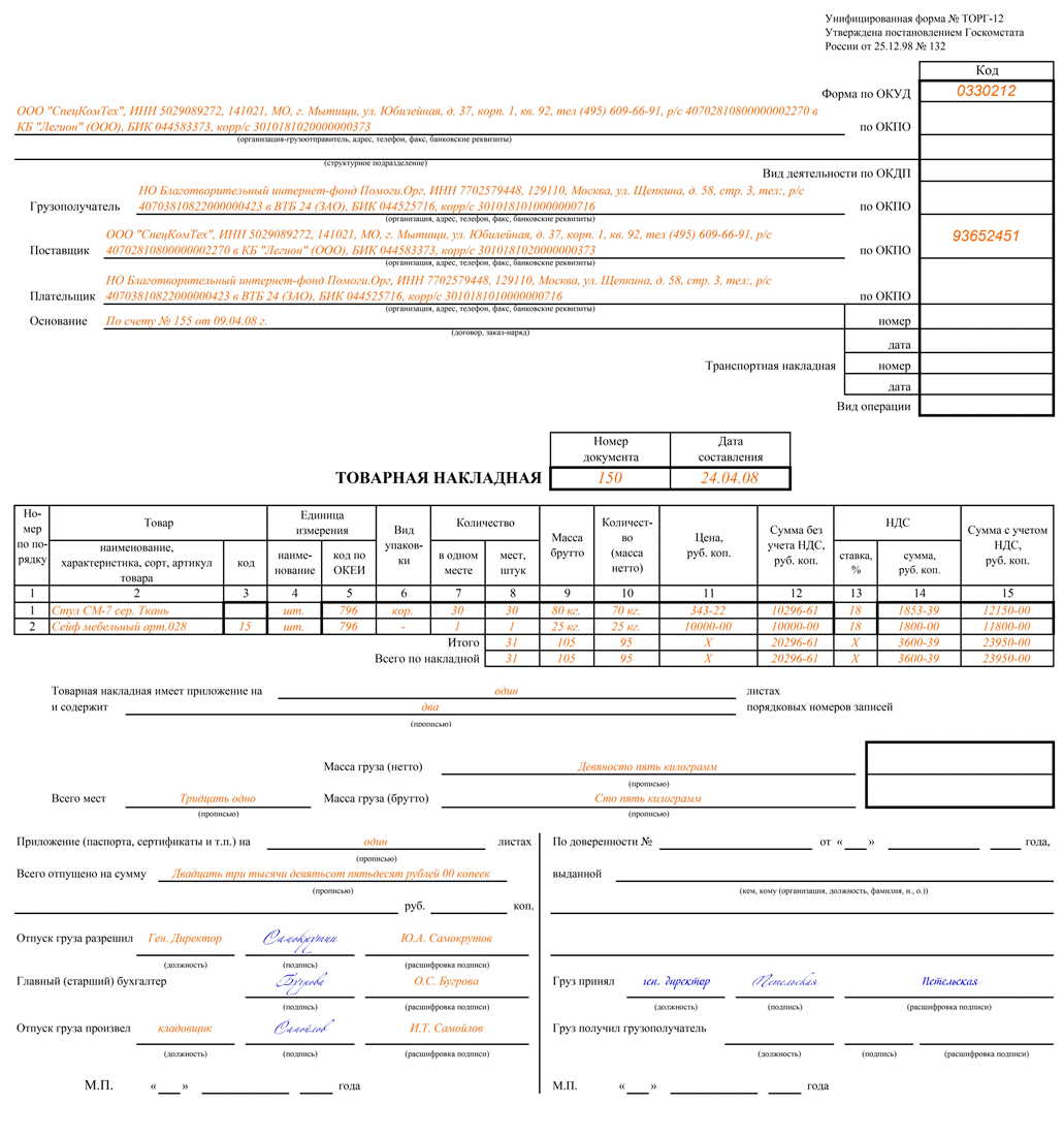

Re: complicated print form [message #753431 is a reply to message #752824] Thu, 27 October 2011 04:45 Go to previous messageGo to next message
That is the examle of print form i need.
  • Attachment: waybill.gif
    (Size: 123.23KB, Downloaded 201 times)

You should be able to do this form in BIRT. For the table headers that
have multiple merged columns and rows you could use a grid or a table.
You just have to select one column or row cell and hold down the shift
key and select another column or row cell and right click and choose
merge cells. Look at the attached example.
Jason
