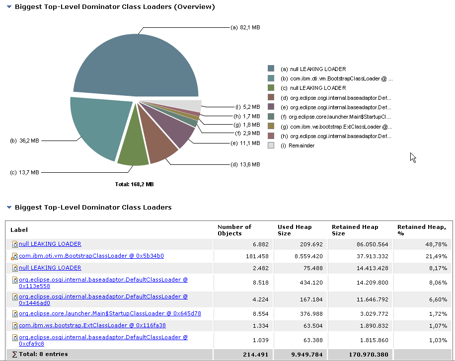

Hi guys,
during memory analizer of our application deployed in IBM WAS 6.1.
I found end fix same memory leak, static class and reference of object Circular and complex bi-directional references, cleaning object in click of the menu(not related to login), fix release of sessionMemoryObject in change site/close windows.
So now I don't have more idea for reduce usage memory..
We have a JEE EAR web application with more than one Java Jar project made by us and we using this principal thirt part lib icefaces,jsf,facelets,spring,hibernate,cxf ecc. with JRE 1.5.
We have yet OutOfMemory(OOM) during automatic test case Sad
My last step of analisys is..
start test in my local Server, after 30 minute, stop test and verify status of memory in server, forcing dump of memory server.
Now my question:
what is null LEAKING LOADER?(see attachment)
is a classLoader memory leak?
how can I understand and solve this type of issue!? (If it is a issue..)
many Thanks, Ste

I don't recognize the text 'LEAKING LOADER' from the standard installation of MAT.
Are you using the IBM Extensions for Memory Analyzer ?
New! IBM Extensions for Memory Analyzer
This blog entry shows a "WebSphere Application Server" > "Application Class Loader leaks" query which might help.
Otherwise try paths to GC roots to see why the loader is still alive.

I think that null LEAKING LOADER was generate because I have analyse a PHD (Portable Heap Dump).
We now try reduce Heap memory of JVM and set server for generate System dump, hoping for better luck.
I also suggest read this good link
www.ibm.com/developerworks/opensource/library/j-memoryanalyzer/index.html#ibm-pcon
p.s.
If I try action Path to GC Roots in some Object, with PHD, it show only che object selected and a not usefull information Unknown
Best regard, Ste.

Stefano, the "null LEAKING LOADER" is indeed part of the IBM Extensions for Memory Analyzer (IEMA) plugins. IEMA has a name resolver for instances of com.ibm.ws.classloader.CompoundClassLoader. The resolver will run some heuristics to see if the CompoundClassLoader is likely to be a leak. The reason it says "null" in front of LEAKING LOADER is that we try to get the name of the application but with a PHD there are no Strings. I will modify it to not print null. We have recently revamped the leaking classloader analysis, so to further investigate, run IBM Extensions > WebSphere Application Server > Class Loaders > Path to Leaking Application Classloaders.
Basically, this is usually caused by a static object or ThreadLocal holding a reference to something in the class graph of the CompoundClassLoader (or a child CompoundClassLoader). This means that if you update an application or stop an application, the CompoundClassLoader cannot be garbage collected. If this happens enough, this can cause native or Java OutOfMemoryErrors.
