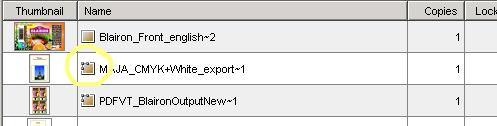

I would like to check the property of an image that is used in a cell in a table:
index.php/fa/4434/0/
As you can see, the icon is not always the same. I want to verify what icon is there (if it is changed form the default one (the one in the first row) to the one with the 3 dots (second row).
I only found a check_property of a graphic component, but can you use this for a cell in a table? Did not find a way to get to the cell, only to the table itself.

have you tried to select the cell (e.g. via ub_tbl_selectcell) and then to check the properties via ub_grc_checkproperty? Maybe this works. If it doesn´t work then I guess you have to write an extension to perform this kind of action (which would be a nice contribution to the Jubula Competition http://pimpyourjubula.eventbrite.com/?ref=ebtn in November Wink )
