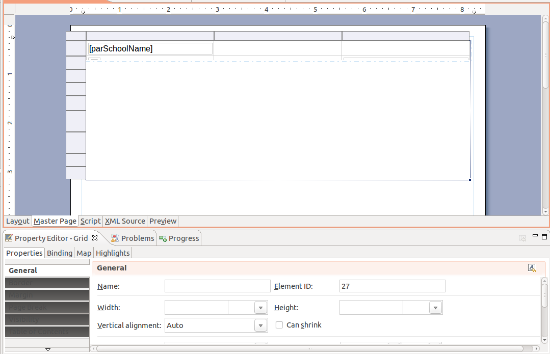

I am struggling to make changes to an existing rptdesign report created on an earlier version of Eclipse and (possibly) the BIRT Report Designer plugin too.
The reason for this is I am unable to view most of my grid contained in the Master Page section of the report so making changes via the GUI is impossible...!
I have attached a screenshot to help explain further.
Any ideas on why it's like this and perhaps how to fix it?
I am running Ubuntu 11.04 with Eclipse 3.7 and BIRT (Eclipse BIRT Project) 3.7.1.
Thanks in advance!
Xandel

I figured out why...
It's a difference between BIRT 2.5.1 and BIRT 2.6.1. The header section no longer allows for a variable height, instead it needs to be defined.
I could only see a portion of my header because the new BIRT was set to 0.5 inches (some default value I assume). By increasing this it no longer truncates my Grid.
While this fixes my issue of being able to work on the Grid, it poses a new problem, it appears BIRT 2.6.1 does not allow for a variable height header / footer? I require the header to be a variable height as the Grid it contains has a variable image in one of its cells...
Any help would be much appreciated!
Thanks in advance!
Xandel

Ah...
Change the "report" property from fixed to auto...
X
