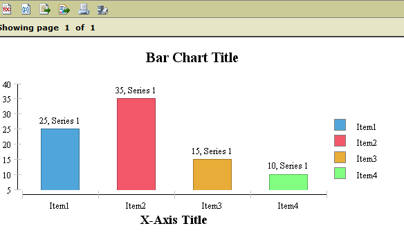

I'm trying to update series name (not legend items: in attached image below i want replace "Series 1" by a runtime value) in a barchart with javascript. I tried beforeDrawSeries event but my code has no effect:
function beforeDrawSeries( series, isr, icsc )
{	series.getLabel().getCaption().setValue('My serie name');
//logInfo('beforedrawseries is fired', icsc);
I also tried beforeDrawSeriesTitle but that event seems never firing.
function beforeDrawSeriesTitle( series, label, icsc )
{	label.getCaption().setValue('My serie name');
//	logInfo('beforeDrawSeriesTitle is never fired', icsc);
Please could someone help
Dom
index.php/fa/4415/0/
[Updated on: Wed, 19 October 2011 04:15] by Moderator

Re: How to set chart series name in javascript [message #741761 is a reply to message #741466] Wed, 19 October 2011 17:52 Go to previous messageGo to next message
Thank you for your reponse Jason.
I set up series label to display "value series name" option, just above each bar. So i'm trying to update this series name to replace it by its parameter value.
I tried your code in the attached report and it works, but labels above each bar chart keep using the old series name :/ Very strange. Are these labels generated before the "beforeGeneration" event?
Re: How to set chart series name in javascript [message #742510 is a reply to message #741761] Thu, 20 October 2011 10:58 Go to previous messageGo to next message
If you change the code a bit and move it to the beforeDataSetFilled
script it should work:
function beforeDataSetFilled( series, idsp, icsc )
var chart = icsc.getChartInstance();
importPackage(Packages.java.util);
importPackage(Packages.org.eclipse.birt.chart.model.data.impl);
importPackage(Packages.org.eclipse.birt.chart.model.component.impl);
importPackage(Packages.org.eclipse.birt.chart.model.type.impl);
importPackage(Packages.org.eclipse.birt.chart.model.attribute);
var xAxis = chart.getAxes().get(0);
var yAxis = xAxis.getAssociatedAxes().get(0);
var xSerieDef = xAxis.getSeriesDefinitions().get(0);
var ySerieDef1 = yAxis.getSeriesDefinitions().get(0);
//logInfo(ySerieDef1.getSeries().get(0).getSeriesIdentifier(), icsc)
ySerieDef1.getSeries().get(0).setSeriesIdentifier("My new series name");
or leave it where it is and add:
runSeries = ySerieDef1.getRunTimeSeries();
firstRunSeries = runSeries.get(0);
firstRunSeries.setSeriesIdentifier("My new series name");
Jason
Re: How to set chart series name in javascript [message #742603 is a reply to message #742510] Thu, 20 October 2011 12:39 Go to previous message
Thanks a lot!! Fantastic that's exactly what i needed!
