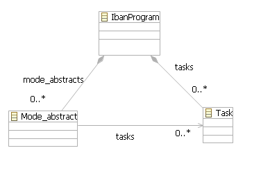

I have an ecore metamodel that has some objects called 'tasks' and some other objects called 'mode_abstracts', as you can see in the attached figure. 'mode_abstracts' have references to tasks, so many different 'mode_abstracts' may have a reference to one task. Everything works more or less ok, but the problem is that if I delete a reference to a task from the diagram, the 'task' element is deleted instead of just the reference, so all the other modes that reference the task get damaged (in the gmfmap file I have tasks inside mode_abstracts, as child references).

maybe I didn't explain it very well, but that's not what I am looking for. My diagram must be synchronized with the model.
My problem is the following. Imagine that my example model looks like the following:
IbanProgram
|--ModeAbstract modename
___|--Task task1name
___|--Task task2name
___|--Task task3name
|--ModeAbstract mode2name
|--Task task1name
|--Task task2name
|--Task task3name
That is, I have defined 2 modes and 3 tasks, where one mode has references to the three tasks and the other has references to two of them.
My problem is that if I don't customize the code, when I delete (for example) the reference between mode1 and task1, task1 element is also deleted, and mode2 becomes erroneous because it has a reference to task1, which does not exist any more.
Customizing the code as I showed in the first message, my diagram deletes the reference between mode1 and task1 as I want, but the model remains unchanged, so when I close and reopen the diagram file, the reference appears again.
What I want is to delete only the reference between (for expample) mode1 and task1, without deleting the task1 element, so that the mode2 remains with a reference to task1, which keeps existing as before. The perfect solution would be to check whether another reference to the task already exists in the diagram, and if not, delete also the element (in the example, if I delete the reference between mode1 and task2, task2 element should also be deleted).
A similar question is treated in http://www.eclipse.org/forums/index.php/m/225928/ , but as I said, the code customization proposed there does not work for me. Does anybody know the solution??
