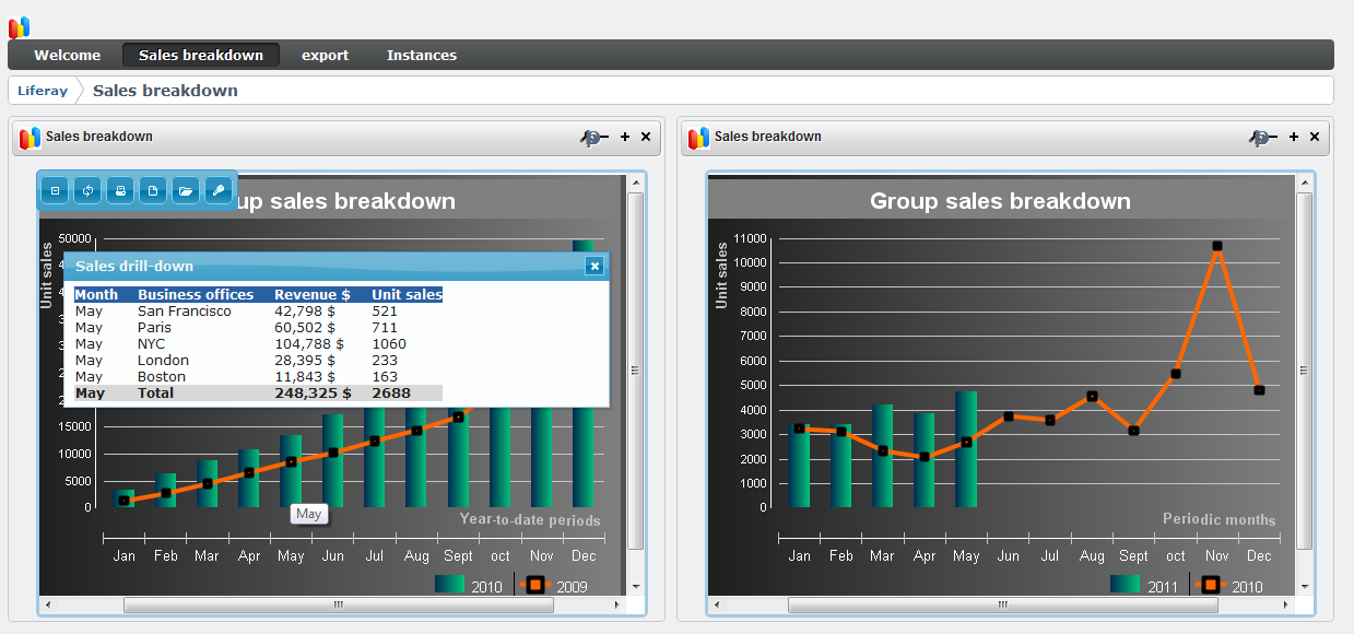

I use a Birt Portlet Viewer, so a report can be present several times on a same page, as showed on the attached image. Thus all birt report are generated with a portlet namespace, and it works pretty well. This portlet namespace is set to birt report context, so i can get it easily in my reports with:
namespace =reportContext.getAppContext().get("namespace");
My problem is when i try to use client-side invoke scripts for chart interactivity. As you can see in the attached image, when i click on a month a tooltip opens showing drill down information. I managed that in a similar manner to Jason's example on birtworld.blogspot.com "Calling Client Side JavaScript from a BIRT Chart" by just calling a javascript function in the invoke script:
myTooltipDrillDown(categoryData)
index.php/fa/4336/0/
But since i cant define namespace in this invoke script, it doesn't work when several instances of a report are aggregated on a same page: i can't specifiy which report should be affected by client-side code, in my example if i click on a month on the second report, it still displays tooltip on the first one. What i need to make it work is the possibility to dynamically insert my portlet namespace in this invoke script, something like JSP syntax:
myTooltipDrillDown(<%=reportContext.getAppContext().get("namespace")%>,categoryData)
Or build it on an event such beforeRendering, with an expression like:
mySerie.<Interactivity invoke script>= "myTooltipDrillDown('"+reportContext.getAppContext().get('namespace')+"', categoryData)"
I'm stuck on this problem i don't know if there is a way to manage that, any help would be much appreciated!

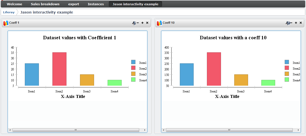

Thanks for your response. To try to clarify this very tough issue, i updated my case with your report example. I just added title and coefficient parameters on your example to distinguish report instances on liferay: as you can see on attached image , a coeff 10 is applied on dataset for the report on the right.
index.php/fa/4401/0/
If i click on item2 for left report, i get an alertbox with '65', which is the correct answer. For report on the right i get '65' too, whereas i should get '650'. If i refresh only the coeff 10 portlet (report on the right), this time when i click on item2 i get '650' for both reports. And if i refresh only the portlet Coeff 1, both reports return '65' again. I hope this explanation makes sense Smile
This behavior seems normal since in this example we should namespace javascript function 'ShowEventData' to make it work as expected. But if we can't generate dynamically the invoke script, unless i misunderstood anything, it doesnt seem possible to use this namespace, that was my problem in my original post.
i think i found a workaround to make this invokescript dynamic. Nevertheless, as i was working on your example i discovered Birt defines the same internal function ID for the 2 invokescripts Sad That seems to be the end of the way for my drill down tooltip feature. Here is the code generated in liferay's page for the invoke scripts attached example:
<Script>function userCallBack1318885099(evt,categoryData, valueData, valueSeriesName, legendItemText, legendItemValue, axisLabel)
  {ShowEventData(evt, categoryData, valueData, valueSeriesName, legendItemText, legendItemValue, axisLabel);
</Script>
<Script>
  {ShowEventData(evt, categoryData, valueData, valueSeriesName, legendItemText, legendItemValue, axisLabel);};
</Script>
It doesnt look to take into consideration namespace option: with this HTMLRenderOption API,
outputOptions.setHTMLIDNamespace(response.getNamespace());
Birt perfectly namespaces every html elements except this one Sad(( I don't know if it is a bug or a normal behavior.

Re: Chart interactivity invoke scripts: how to dynamically generate a script [message #740490 is a reply to message #740238] Tue, 18 October 2011 11:08 Go to previous messageGo to next message
That does sound like a bug.
Jason

Re: Chart interactivity invoke scripts: how to dynamically generate a script [message #740619 is a reply to message #740490] Tue, 18 October 2011 14:07 Go to previous message
Thanks for your time. I logged this issue on bugzilla as Bug 361285.
