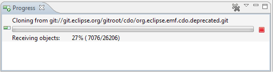

I tried it again and now it gets stuck at 27%:<br>
<br>
<img src="http://www.eclipse.org/forums/index.php?t=getfile&amp;id=4334" alt=""><br>
<br>
Do I have to repeat 7.6923 times? :P<br>

Am 15.10.2011 18:41, schrieb Eike Stepper:
Jokes aside, repeating the same exercise always freezes at 27%.
One thing I've noticed when using a command line tool for cloning is that the Git objects that are received at 27% seem
to be quite large. The command line tool shows the total received bytes and I can see constant progress. but this
progress does not have a big impact on the number of received objects. Not enough to impact the percent value of the
reported progress.
To really be able to notice a freeze (a bug or network issue) as opposed to receiving large objects it would be helpful
to display the display the size of the received objects in the job's task message.
Please note that in my case it really freezes at 27% and I don't seem to have other network issues.
Cheers
/Eike
