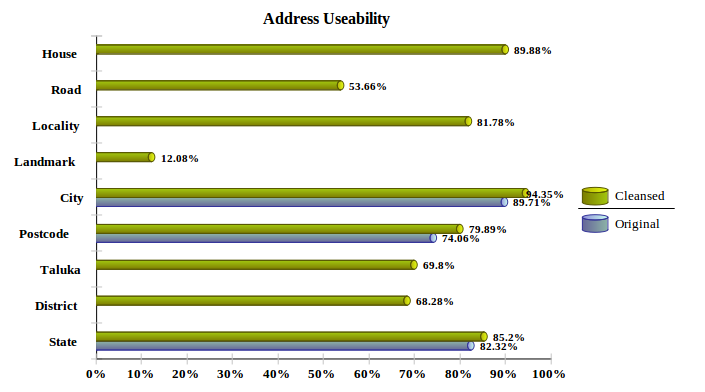

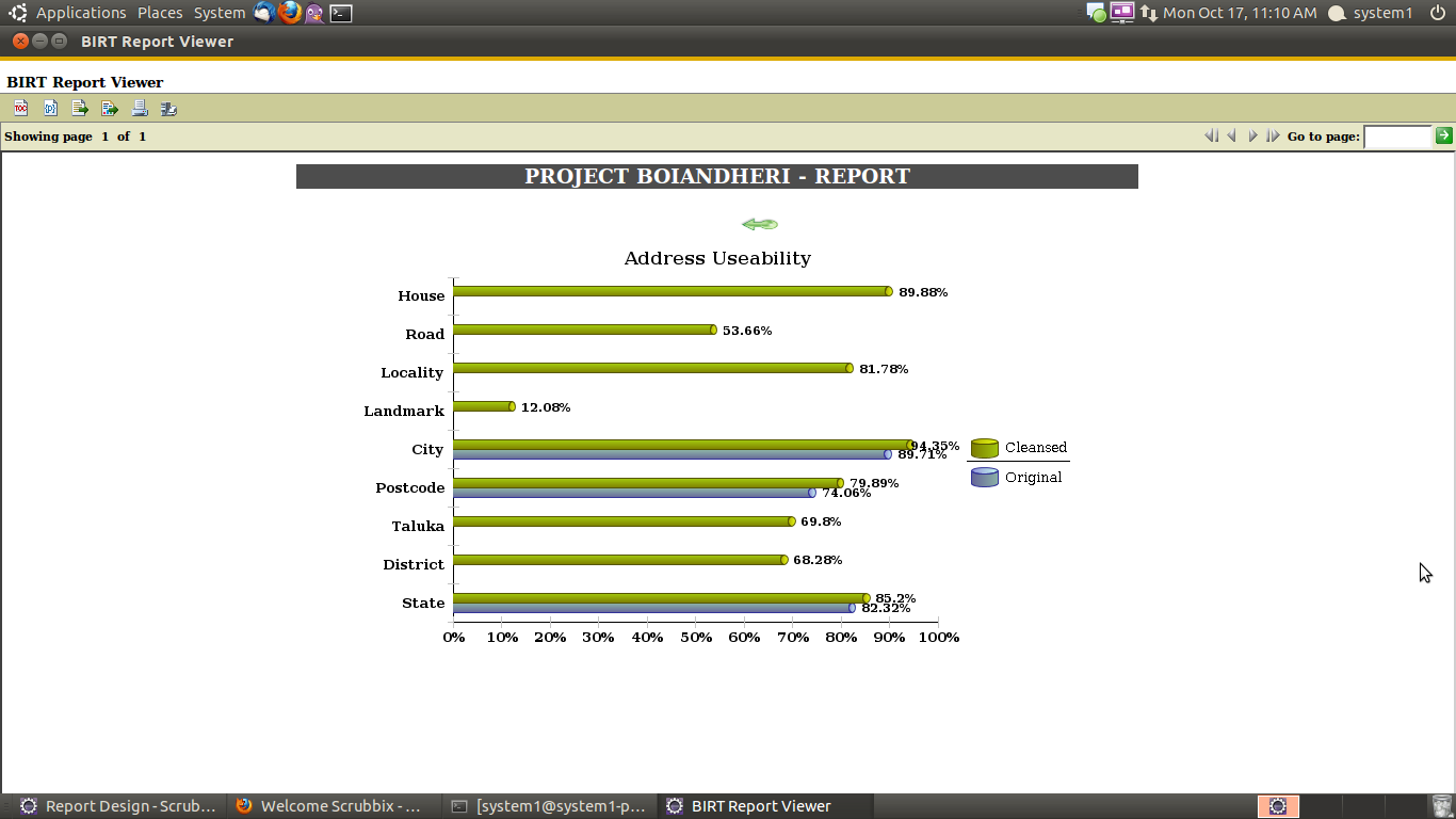

Image chart2.png is the report run through birt report viewer and chart1.png is the report run in web application. Labels House , City etc. are not properly aligned. I want that to be right aligned. Is it possible?
Gauri

Right justified should be the default. Any chance you can reproduce
this with the sample data? What version of BIRT are you using? Are you
just calling the report engine through a servlet?
Jason
