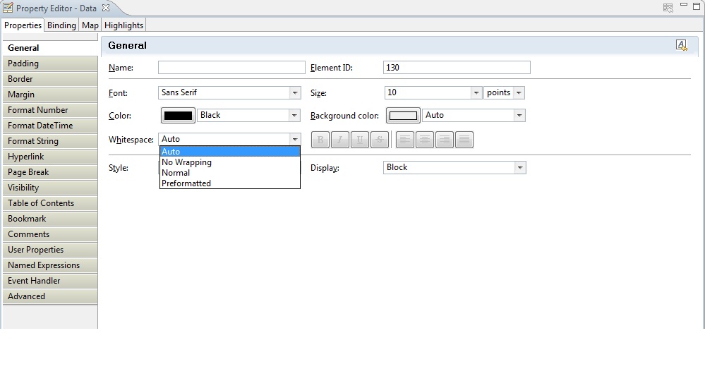

Re: Wrap text in a cell [message #900633 is a reply to message #740689] Tue, 07 August 2012 17:17 Go to previous messageGo to next message
No need to write wrap() function. We have the properties available in Birt design template for wrapping the text.
1. Once you placed the dataset column element inside table / grid / cell. Select the dataset column element from table / grid and go to properties.
2. Under General pane in properties window, make sure it displays "Properties - Data" on that top. This is to make sure you are in dataset element properties.
3. Update "Whitespace" properties as "Auto". It will be there in General pane.
2. DO NOT go to table / grid properties.
Please refer the attachment.
Note: I have faced the same issue, "wrap text is not working in my excel". After 1 week, i found this option. Now word wrap is working fine.
