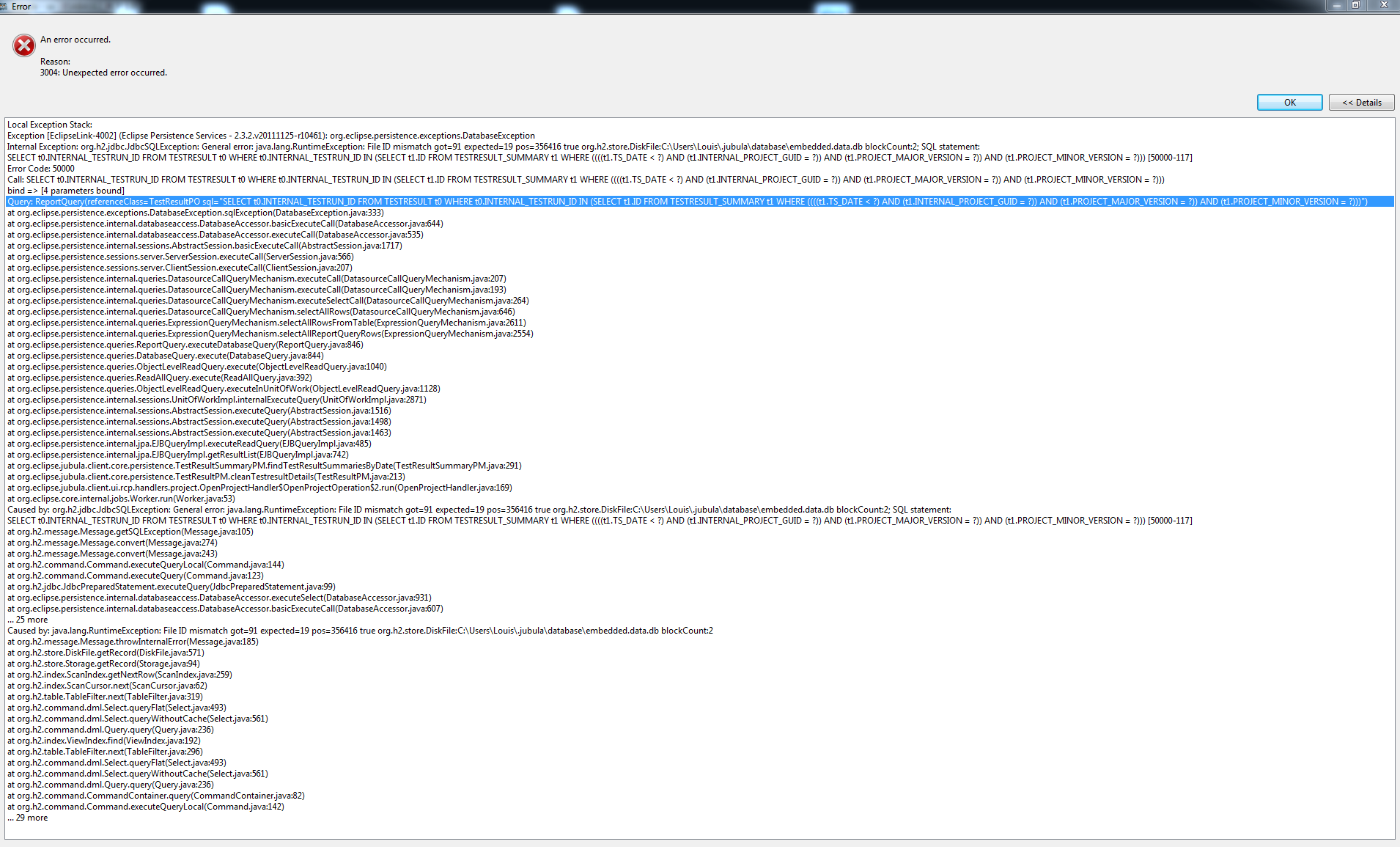

Re: Export is not working with plugins installed in eclipse [message #1243665 is a reply to message #735996] Tue, 11 February 2014 04:21 Go to previous messageGo to next message
Hallo all,
I have also a problem with exporting Jubula Projects.
It was working few days ago, but today I was trying to export jubula project as XML as usual, it did not work.
The error message you can find in the attached file.
What can be the reason for this problem, my guess is that I am using the internal database H2?
Thank you for your kind reply
louykoko at yahoo dot com
Louis
Re: Export is not working with plugins installed in eclipse [message #1243933 is a reply to message #1243665] Tue, 11 February 2014 12:09 Go to previous message
Can you provide the log entry that occurred at the time when you tried to export?
Can you reproduce the behaviour after a restart of Jubula?
Without knowing more, I can't say whether the problem is due to the H2 database, but we do not recommend using it for productive testing.
Alex
