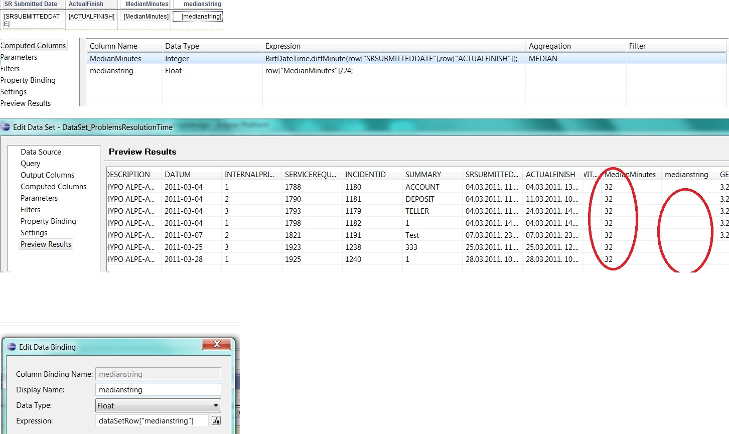

Re: MEDIAN function on string??? [message #741202 is a reply to message #736113] Wed, 19 October 2011 05:36 Go to previous messageGo to next message
Hi Jason. Thanks for your reply and effort. You are really helping me.
You send me great example and I did it all like you. My computed column Median Minutes is always correct calculated but medianstring computed column is always empty.
I don't know why? I tried with some simple example just as Float to calculate from Median Computed column divided by 24 but that is also empty. Do you see maybe what is wrong? Here is all settings:

Re: MEDIAN function on string??? [message #741215 is a reply to message #736113] Wed, 19 October 2011 05:51 Go to previous messageGo to next message
You send me great example and I did it all like you. My Median Minutes column is always correct calculated but medianstring column is always empty. I copy paste your example but it stays empty. I tried and with simple example to use that column as Float-- Median Minutes divided with 24 but it stays empty. Do you maybe see what am I doing wrong? Here is all the settings:
index.php/fa/4419/0/

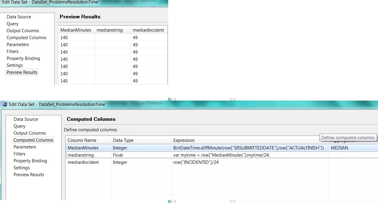

Re: MEDIAN function on string??? [message #741275 is a reply to message #735945] Wed, 19 October 2011 07:10 Go to previous messageGo to next message
Jason just to add-- I added new computed column which calculates from standard output column INCIDENTID and that works ok. But for similar expression medianstring stays empty. It's like medianstring cant pull out information from computed Median Minutes column. do you know the reason?
thanks for help

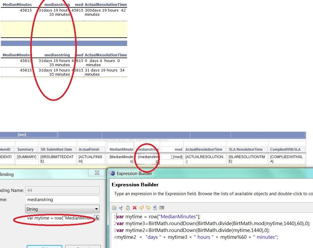

Re: MEDIAN function on string??? [message #742140 is a reply to message #741449] Thu, 20 October 2011 04:05 Go to previous messageGo to next message
Hi Jason.
It's again empty.
But never mind I succeeded to present median string results. Solution was that I used only one computed column (Median Minutes) and on report medianstring column is not bound to medianstring computed column.I bound it with expression
var mytime = row["MedianMinutes"];
var mytime3=BirtMath.roundDown(BirtMath.divide(BirtMath.mod(mytime,1440),60),0);
var mytime2=BirtMath.roundDown(BirtMath.divide(mytime,1440),0);
mytime2 + "days " + mytime3 + " hours " + mytime%60 + " minutes";

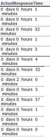

Now it works OK. I just have only one question can I display this result just in one field-out of the table in some field. Because this result can be repeted n-times through the table as you can see in attachment. I saw also that in your example also there was repetition of result?? Can it be shown only once??

Re: MEDIAN function on string??? [message #742494 is a reply to message #742140] Thu, 20 October 2011 10:44 Go to previous messageGo to next message
Select the column on the table and look in the general properties.
There is a check box to suppress duplicates.
Jason
