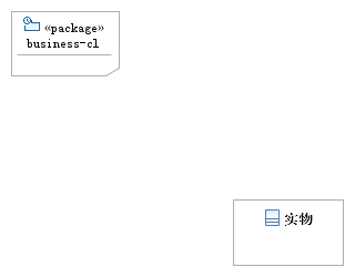

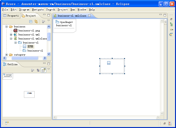

Changes a class' name into Chinese on class diagram, and the name in the class notation dispeared. For example:
1. drop a class into the class diagram;
2. and rename it as '实物';
3. and then, it displayed a class notation with blank name on diagram.
While, in .uml file which encoding as utf-8, there is a class named as '实物' correctly. So as the name shown in project explorer window for .umlclass correctly.
Save it as image file, and get a correctly named png image.
figure1: eclipse window
index.php/fa/4209/0/
figure2: saved as image file
index.php/fa/4210/0/
