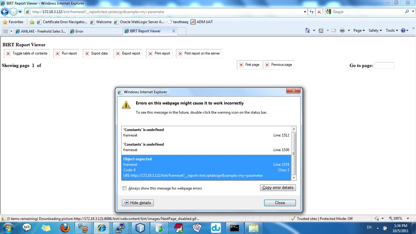

I installed BIRT with tomcat and trying to test the default reports provided. In IE8 it is giving me error at attached. In Firefox, it is not displaying any report, instead the blank is appearing.

The viewer uses AJAX and web services to update the frameset. I am
wondering if there is a port conflict. You could try using the preview
mapping instead of the frameset as well. I also noticed in the
screenshot that the image is trying to get to port 8086.
Jason

Now when we have removed Apache and using the tomcat directly, the same issue appears with frameset. Same as in attached file. Preview is fine. OS is RedHat.

Not exactly, first page doesn't load. After long time it starts loading with same result as attached in this post. Images don't come and with the shown script error. Firefox also keeps on loading, but never shows the report. Same issue in "run" mode as well. "Preveiw mode is fine".
This error is reproducible using the test report also as shown in attached image.

> Do you mean security manager or some ownership issue....
Re: BIRT not working with IE8 with tomcat, Object expected error [message #753361 is a reply to message #753360] Wed, 26 October 2011 16:25 Go to previous messageGo to next message
It is secured. I'll try to deploy again. Can you give any reference of documentation on this, with mention of security steps. It has to be done on redhat.
Re: BIRT not working with IE8 with tomcat, Object expected error [message #753526 is a reply to message #753361] Thu, 27 October 2011 11:07 Go to previous message
I was referring to this bug:
https://bugs.eclipse.org/bugs/show_bug.cgi?id=182161#c32
I am not certain this is the same issue.
Jason
> on redhat.
