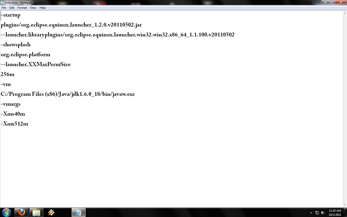

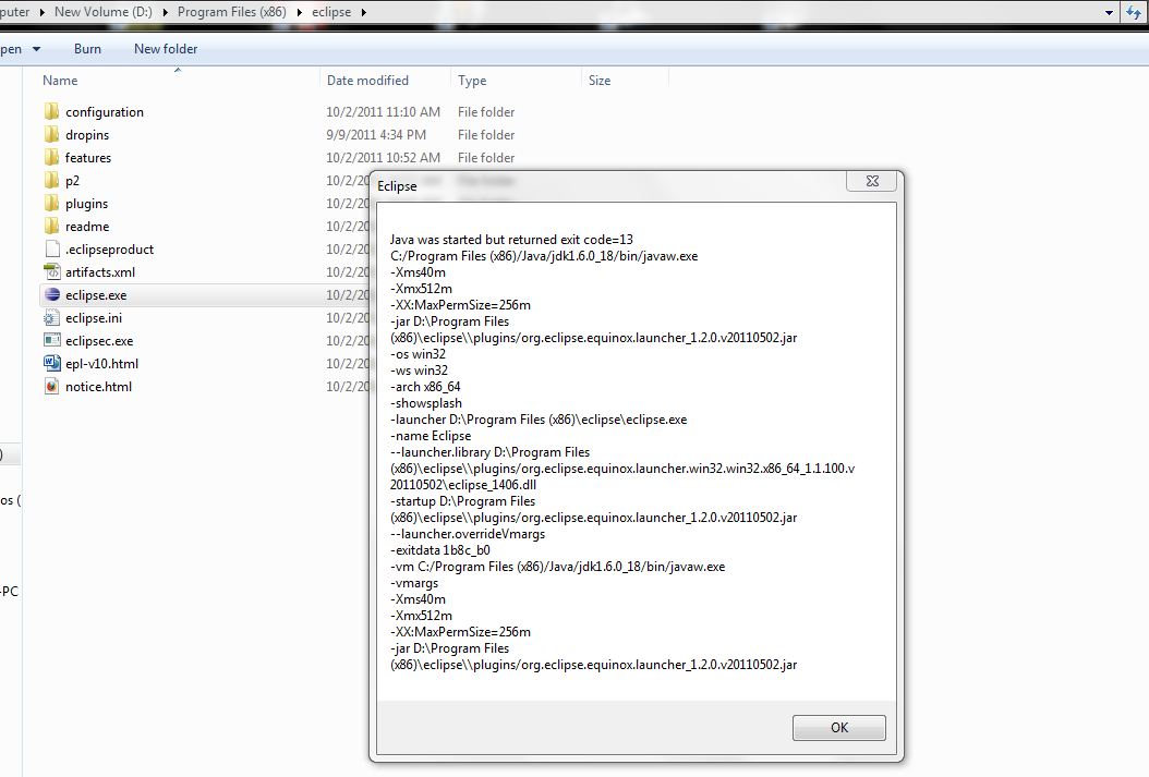

I am a total newcomer to eclipse
while doing installation i read all the documents told and did wat ever i understood
but eclipse still wont start
pls help
i am using Windows 7 64 bit
With Java 1.6
i did the the changes in the eclipse.ini fileindex.php/fa/4120/0/ as said but i still get the exit code 13index.php/fa/4121/0/ while starting
> pls help
> With Java 1.6
> i did the the changes in the eclipse.ini file as said but i still get the exit code 13 while starting
You're attempting to run a 64-bit Eclipse on a 32-bit JDK?

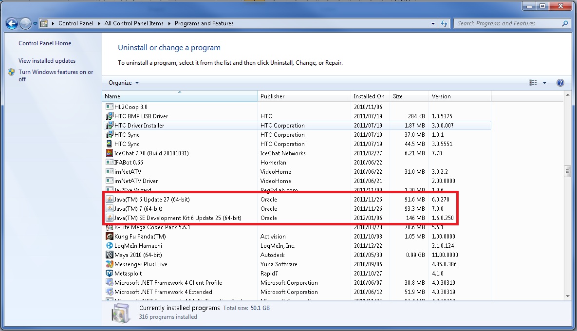

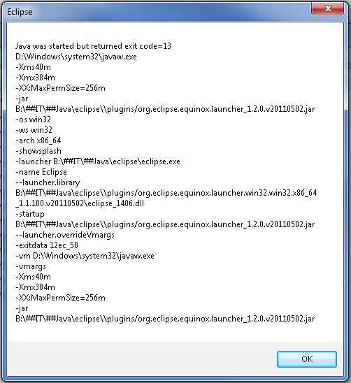

But I have a Similar Problem:
index.php/fa/6663/0/
index.php/fa/6664/0/

I have Changed the .ini File to Specify JVM but still same Problem...
I Tried the Following paths:
D:\Program Files\Java\jdk1.6.0_25\bin\javaw.exe
D:\Program Files\Java\jre7\bin\javaw.exe
  • Attachment: Eclipse.jpg
    (Size: 78.18KB, Downloaded 1225 times)
  • Attachment: Java.jpg
    (Size: 216.80KB, Downloaded 1162 times)

Yes, you do have to specify the path to the JRE in eclipse.ini. The path
you have there doesn't look very likely.
> The fact that his eclipse is in his 32x Program Files it Suggests Differently ^.^
> It seems that it is referring to Java in my System 32? Which makes no sense to me at all...

Wow 12x MultiPost Razz
I did Specify the paths in the .ini

>B:\##IT\##Java\...
Do not use '#'. ('!' as well)

That is just the location of my Eclipse?
Re: Not able to run eclipse [message #777426 is a reply to message #777341] Tue, 10 January 2012 08:35 Go to previous messageGo to next message
On 2012.01.10 3:04, Mark Coetzer wrote:
> Toshihiro Izumi wrote on Tue, 10 January 2012 03:00
>> >B:\##IT\##Java\...
So, that was to obfuscate your filesystem details from the rest of us?
Or are you actually using pound signs in subdirectory names?
If the latter, and as you have no idea what tools underneath you expect,
you are tempting fate any time you use other than
[A-Za-z_][A-Za-z0-9_]*. I don't advise spaces even though they're
probably safe (however ugly on Linux). I can't say precisely that #
won't work in Eclipse on Windows, but Toshihiro's post brings up a very
good point.
I would suggest setting up Eclipse using boring, canonical assumptions
first, get it running, then go back and try it again using you favorite,
special characters. Simple renaming might also achieve your cosmetic
effect, but be careful as renaming might be too shallow an operation
that leaves you disconnected from deeper configuration you can only
change through actual set-up.
Re: Not able to run eclipse [message #777610 is a reply to message #776396] Tue, 10 January 2012 15:04 Go to previous messageGo to next message
Mark Coetzer wrote on Sun, 08 January 2012 02:54
Then you either didn't define the location correctly, or there isn't a jdk/jre at either of those locations because the screen shot shows that the Eclipse launcher found a VM in the D/Windows/System32 directory.
You need two lines in the eclipse.ini file
-vm
location of javaw.exe
These have to be included before the -vmargs line. If you include them after -vmargs, they will be added to the vm launch command instead of being used to locate the vm.
Re: Not able to run eclipse [message #777641 is a reply to message #777610] Tue, 10 January 2012 16:16 Go to previous message
I did modify the .ini Correctly ^.^
But it does seem the problem was the '#' signs because I extracted Eclipse Directly onto my B Drive and it Worked Smile
Thanks for the help
