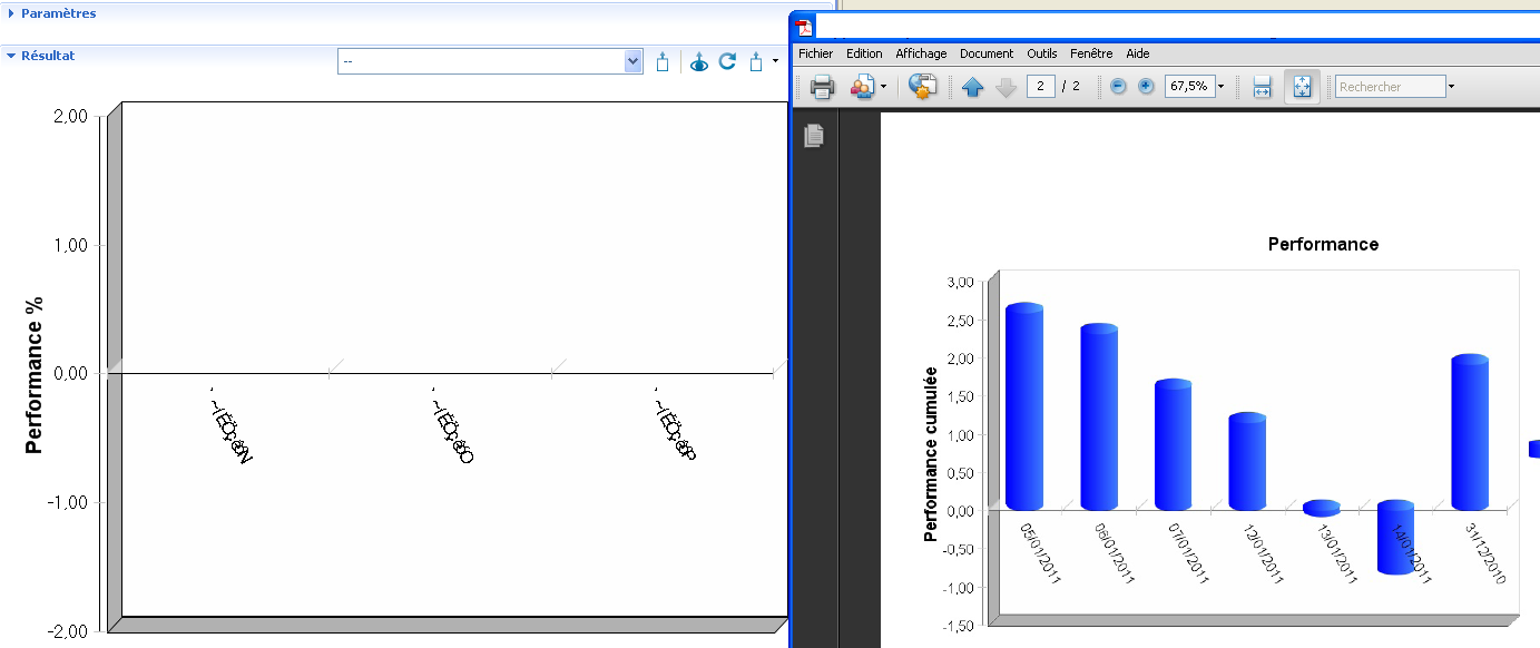

I use my own emitter based on org.eclipse.birt.report.engine.emitter.IContentEmitter to deal with report & chart in SWT world.
I have problem with charts since i move on to birt 3.7
Here is my code
    public void startImage(final IImageContent image)
        try
            super.startImage(image);
            ExtendedItemDesign eid = (ExtendedItemDesign) image.getGenerateBy();
            ExtendedItemHandle eih = (ExtendedItemHandle) eid.getHandle();
            Chart chart = (Chart) eih.getReportItem().getProperty(
                    "chart.instance");
           ... SWT action on Chart object
        catch (Exception e)
When i use a PDF or HTML emitter I don't have any problem.
index.php/fa/4071/0/
But with my SWT emitter I have problem that you can see in attachment file.
It seems that the dataset are corrupted.
I specify that it works perfectly with Birt 2.3.2.
Otherwise if I use a chart object created from scratch using org.eclipse.birt.chart.examples, instead of call getProperty("chart.instance") it also works with BIRT 3.7.
Any idea ?
Thanks for your reply.
  • Attachment: BIRTpng.PNG
    (Size: 89.08KB, Downloaded 586 times)
Re: Migration problem to BIRT 3.7 [message #730127 is a reply to message #730093] Tue, 27 September 2011 12:37 Go to previous messageGo to next message
Philippe,
This is most likely because the chart.instance does not store the data.
Are you trying to regenerate the chart?
Jason

Re: Migration problem to BIRT 3.7 [message #730337 is a reply to message #730127] Wed, 28 September 2011 03:53 Go to previous messageGo to next message
Jason,
No I'm not trying to regenerate the chart, I want to retrieve my chart instance to use it.
This use is based on basic examples such as com.ibm.examples.chart.widget.ChartWithToolTipCanvas or org.eclipse.birt.chart.examples.api.viewer.SwtLiveChartViewer. In this both examples, the chart is created from scratch. In my case, I'm using a rptdesign file with a scripted data set. And it works perfectly when i deal with a pdf emitter.
I want to use the chart properties for displaying tooltips and create interactivity, and this cannot not be done with a simple Image. I really need the chart instance.
But it seems to have problems since i use 3.7.
sincerely yours
Philippe

Re: Migration problem to BIRT 3.7 [message #733418 is a reply to message #732333] Tue, 04 October 2011 13:03 Go to previous message
The reason this is failing is that the chart instance does not store
data. So when your chart builds it does not find any data, because you
replaced the original chart with the one from the report. To get around
this just re-bind the data after you read it from the report. In your
example I got it to work by modifying the SampleEditor class. Right above:
canvas.setChart(chart);
canvas.setSize(800, 600);
I added:
DataSet dataSet = new DataSet();
NumberDataSet orthoValuesDataSet1 =
NumberDataSetImpl.create(dataSet
.getTechnitians());
NumberDataSet orthoValuesDataSet2 =
.getSalers());
TextDataSet categoryValues = TextDataSetImpl
.create(dataSet.getCities());
// X-Axis
Axis xAxisPrimary = ((ChartWithAxes) chart).getPrimaryBaseAxes( )[0];
SeriesDefinition sdX = (SeriesDefinition)
xAxisPrimary.getSeriesDefinitions( )
.get( 0 );
( (Series) sdX.getSeries( ).get( 0 ) ).setDataSet( categoryValues );
// Y-Axis
Axis yAxisPrimary = ((ChartWithAxes) chart).getPrimaryOrthogonalAxis(
xAxisPrimary );
SeriesDefinition sdY1 = (SeriesDefinition)
yAxisPrimary.getSeriesDefinitions( )
.get( 0 );
SeriesDefinition sdY2 = (SeriesDefinition)
.get( 1 );
( (Series) sdY1.getSeries( ).get( 0 ) ).setDataSet( orthoValuesDataSet2 );
( (Series) sdY2.getSeries( ).get( 0 ) ).setDataSet( orthoValuesDataSet1 );
I am attaching that class file.
Jason
