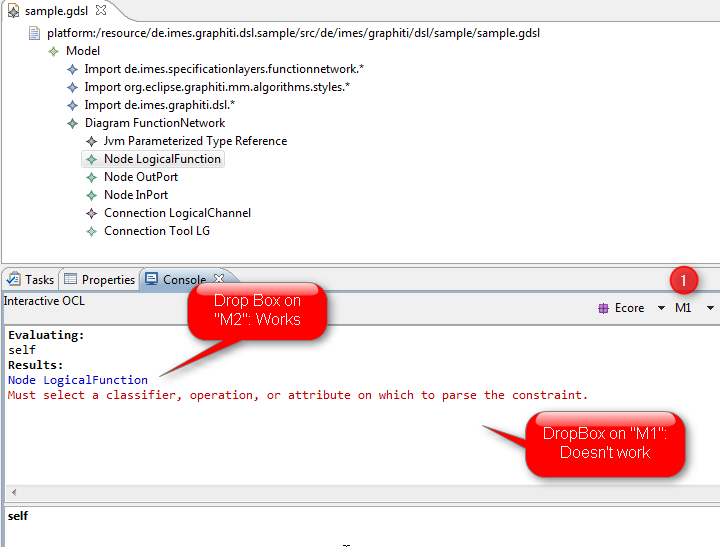

I was referring to "M2" and "M1" as the choices on the drop down box of the OCL interpreter. I have attached a screenshot to illustrate my question.
I am opening my EMF model with the sample reflective ecore editor and then opening an ocl interpreter console with the context menu.
As long as the choice box is set to M2, the queries work well. But I want to be able to specify queries on the M1 level (not execute them, just use the ocl console to edit them).
In the example, a query "self" with M2 set returns "Node LogicalFunction". However, for further processing in another tool, I would like to be able to specify queries on "M1", which I'd expect to return an object "LogicalFunction" for "self".
But obviously, OCL could not know how to infer types and attributes for arbitrary meta-models.
In the end, for nodes LogicalFunction / InPort etc. as from the example, I would like to be able to use those as "1st class citizens" in the OCL query.
Hope that clarifies,
Andreas

Ah, that M1/M2. When I cloned the OCL Console for the OCL Xtext Console
I had no idea what the M1/M2 dropdown really did and so I dropped it.
The main usage seems to be for UML where the auto-translation to Ecore
can provide confusion over which model is in use.
You could try the OCL Xtext Console; it might be less fussy, but I don't
think what you're trying to do is reasonable.
OCL can evaluate values in any context but as soon as you want to use
objects, you must have meta-models.
Your LogicalFunction Node is an instance of the Node meta-model element
and so you may use Node-related functionality.
If you want to use LogicalFunction-related functionality then you need
to provide the meta-model in which presumably LogicalFunction is a form
of Operation.
Eclipse OCL is Open Source software so of course it's possible, but
emulating the existing Ecore or UML bindings for 'Logical' is a
significant undertaking. The xxxEnvironment is just a small part of this
activity.
The new Pivot model that supports the Xtext-based functionalities is
neutral, so there you have the much simpler task of providing a
Logical2Pivot converter. However the pivot code is of example quality
and is evolving to provide APIs that should make this kind of activity
significantly easier.
I've raised https://bugs.eclipse.org/bugs/show_bug.cgi?id=358853 so that
an Xtext Console might reinstate the 'M1' option to support an
Alien2Pivot converter, which might be what you want.
Today, you could try a Logical2Ecore converter, or, not recommended at
all, arrange for your LogicalFunction to extend EOperation.
Ed Willink
