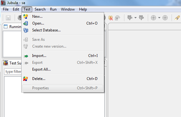

whenever I try to make a new project, via the "test->New..." wizard, nothing happens.
According to the cheat sheets I should be able to edit the new project's properties next which is not possible for me since no project seems to have been created.
The attached partial screenshot shows the state after I've tried to create a new project.
I have the same problem with Jubula standalone as well as the eclipse for testing version.
I use the default embedded database and the console output says "Connection to Database successful".
Opening "unbound_modules_rcp" and "unbound_modules_html" projects works.

The best place to check would be in the log files (via the help menu). If you fill out the new project dialog then click "Finish", then a project should be created and opened automatically.
Maybe there is some database-related problem which can be seen from the log files.

I've just solved the problem - the error was the user Wink
I didn't check the manual for required JDK version and had JDK 1.7 64Bit version installed.
Have installed 1.6 32Bit version now and after deleting the ".jubula" folder from my user folder, Jubula now works.
Thanks for the help! Smile
