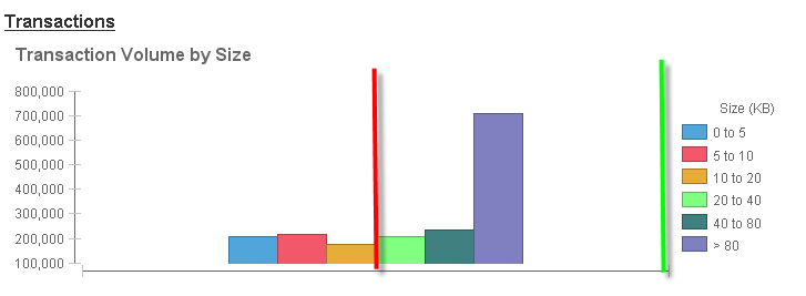

index.php/fa/4007/0/
The green line is where the marker line comes out but the red line is where I want it. The problem is that all the bars are from different series and there is only one row so the x axis only has one point on it.

Mike,
Add the following beforeDrawMarkerLine script:
function beforeDrawMarkerLine( axis, markerLine, icsc )
importPackage(Packages.org.eclipse.birt.chart.model.component.impl);
importPackage(Packages.org.eclipse.birt.chart.model.data.impl);
importPackage(Packages.org.eclipse.birt.chart.model.attribute);
importPackage(Packages.org.eclipse.birt.chart.model.attribute.impl);
importPackage(Packages.org.eclipse.birt.chart.util);
markerLine.setValue(NumberDataElementImpl.create(0.5));

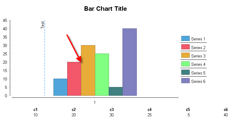

Hi Jason,
Doh! For some reason my mind was stuck on integral values... this was just too easy. Well actually it was too easy. In actual fact I don't want the marker line at the halfway point. I'd like to place it on the right edge of the 2nd bar (as shown by the arrow). I'm not sure how to calculate this offset and tie it to the number of bars. I tried multiples of 6 (number of bars) and multiples of 7 (number of edges). The image shown is 3*(1/7) but as you can see it places the marker a little too far to the right. Is there an easy formula I can use or do I just have to fudge it and hardcode a value that works?

Re: Dynamically add a marker line to a chart [message #727633 is a reply to message #727479] Wed, 21 September 2011 13:54 Go to previous messageGo to next message
That is a bit more complicated. Look at the attached example.
Jason

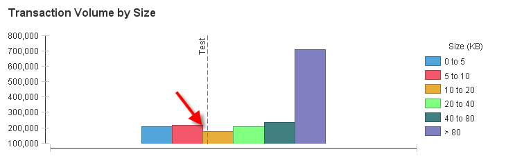

Hi Jason,
I think this is getting closer but my chart is configured a little differently and the code you supplied doesn't appear to calculate the correct positions. I have included a sample chart with the configuration that I am using and the arrow points to where I would like the marker line to be positioned. The actual marker line is where the current code puts it.

Re: Dynamically add a marker line to a chart [message #728216 is a reply to message #728077] Thu, 22 September 2011 14:12 Go to previous messageGo to next message
Can you lower the unit spacing (which is getting added per series).
See modified example.

Re: Dynamically add a marker line to a chart [message #728527 is a reply to message #728216] Fri, 23 September 2011 08:32 Go to previous messageGo to next message
Hi Jason,
This almost works. The example works but when I applied this code to my actual chart the line was still out (to the right). So I went back and forth a million times to try to figure out what the difference was. I finally figured it out that it was the legend. In my actual chart code I had different place holder names for each of the series which I subsequently modified in my beforeDrawLegendItem script. One of the place holder names was long (eg., "Brobdingnagian"). The chart formatted based on the width of the legend as it was specified in the designer. At runtime the width of the legend was actually smaller which threw out the calculations for the marker.
I have worked around this by changing the place holder names to something shorter since they don't actually display anyway, but for future reference, I was wondering if there was still a minor tweak to the code that would account for this?
