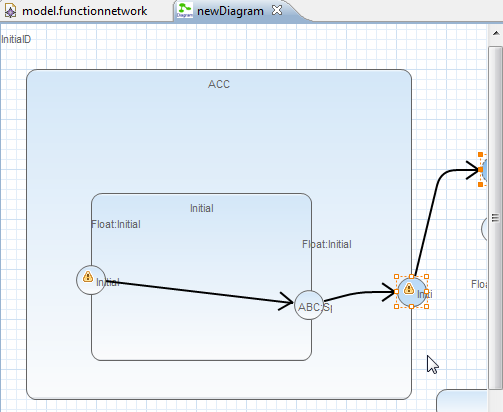

I am setting the selection programmatically, which works fine. However, I want to make sure that all selected elements are visible. Is there a way to programmatically scroll / zoom the diagram in the editor?

Hi Jos,
here is my code:
 public void execute(ICustomContext context) {
    	PictogramElement[] pes = context.getPictogramElements();
    	if (pes != null && pes.length == 1) {
           PictogramElement pe = pes[0];
           if(pe instanceof Connection)
        	   Anchor sa = ((Connection) pe).getStart();
        	   Anchor se = ((Connection) pe).getEnd();
        	   getFeatureProvider().getDiagramTypeProvider().getDiagramEditor().selectPictogramElements(new PictogramElement[] {
        			   sa.getParent(),
        			   se.getParent()
(I am selecting the peers of a connection).
However, there is no scrolling in this case. (see attached screenshot).
If I reverse the order of pictogram elements, (se.getParent(), sa.getParent()) I see some scrolling. I guess it depends on primary / secondary selection?.
Andreas

Re: Scrolling / zooming programmatically [message #725592 is a reply to message #725245] Thu, 15 September 2011 05:54 Go to previous messageGo to next message
Andreas,
the selection method only uses the first element in the given array, that's
what GEF allows there. So this explains the behavior you have noticed.
Michael

Re: Scrolling / zooming programmatically [message #725606 is a reply to message #725592] Thu, 15 September 2011 06:38 Go to previous message
OK, that explains that. Would there be another way to scroll and zoom the diagram?
