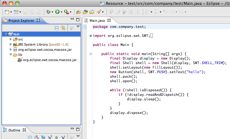

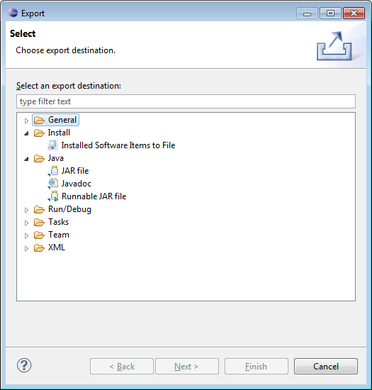

Unfortunately, there is no "other" category visible in my Export wizard. I've downloaded "Eclipse IDE for Java Developers" and created a small test project with SWT code.

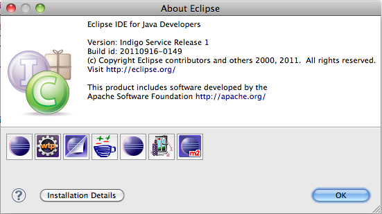

I tried the "Eclipse IDE for Java Developers" 3.7.1 version and the export wizard does have the other category (tried File > Export... )

Sorry, I've downloaded a fresh copy of eclipse-java-indigo-SR1-win32.zip and when I invoke File -> Export there is no Other node. Maybe you have installed some additional plugins I don't have?

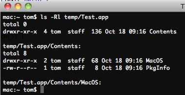

You are right, this feature is available in OS-X-Eclipse. Unfortunately, the result looks very basic: I've got just following directory structure
Test.app/
[-] Contents
   [-] MacOS
   PkgInfo
That's it. Nothing in the MacOS directory, no Info.plist, no library (though I told it to use my launch configuration).

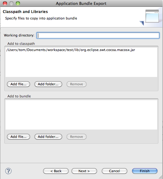

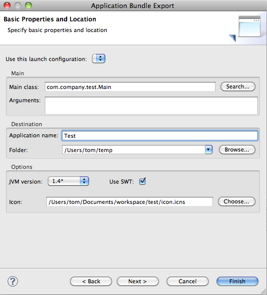

I've tried again. Please see following screenshots.
index.php/fa/4395/0/
index.php/fa/4396/0/
index.php/fa/4397/0/
index.php/fa/4398/0/
index.php/fa/4399/0/
Please note following bugs:
- the "Use this launch configuration" combobox is too narrow
- selecting the item from the "Use this launch configuration" combobox does not pick any main class or classpath entry
- clicking the "Search" button right beside the Main class input field does nothing
