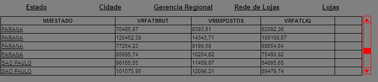

Hi guys,
I need to put a scrollbar in a table element, is this possible?
  • Attachment: iwish.PNG
    (Size: 10.90KB, Downloaded 132 times)

You could probably do this using a text element. Look at the attached
example that uses a text element in a table footer. Note that the table
header and detail rows are hidden. An onCreate script on the table and
detail row is used to build a table to use in the text element in the
footer. The text element has an oncreate script to set its text based
on the value created in the table/rows.
Jason
