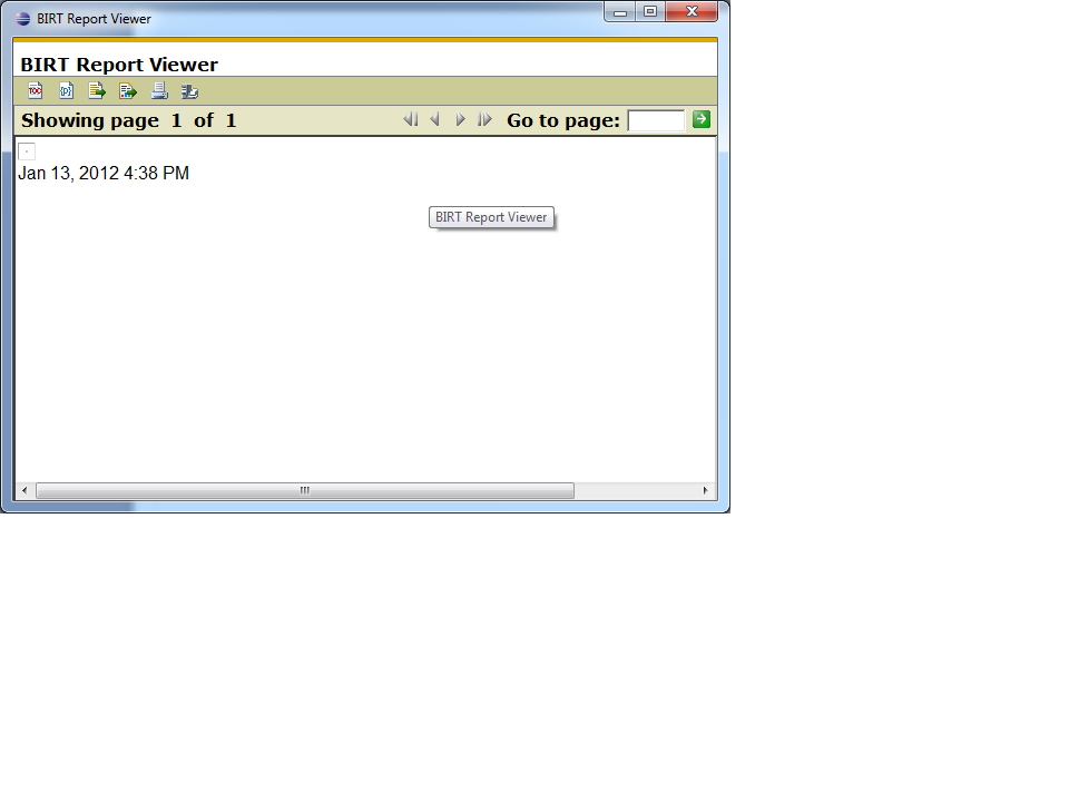

Re: Dynamic SVG Image: Item is not supported [message #778804 is a reply to message #778775] Fri, 13 January 2012 16:46 Go to previous messageGo to next message
Hi Jason,
It runs without error, but it didn't render the SVN. I've attached an image of the output.
I installed the BIRT reporting version of Eclipse about two weeks ago, so I should be current. I've also attached a dump of my configuration.
Many thanks for your assistance!
- Chris
