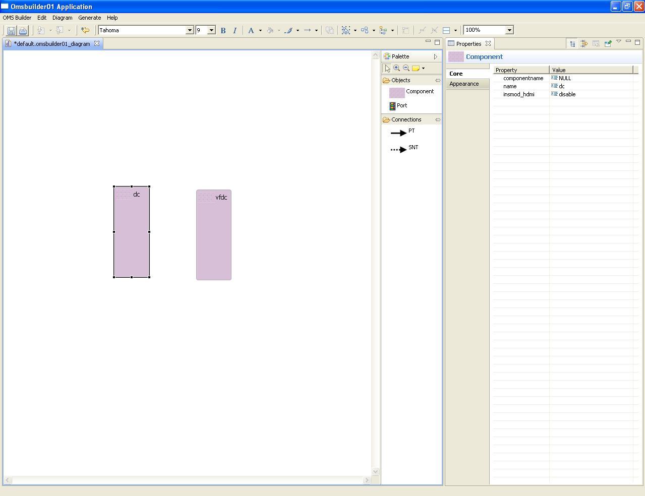

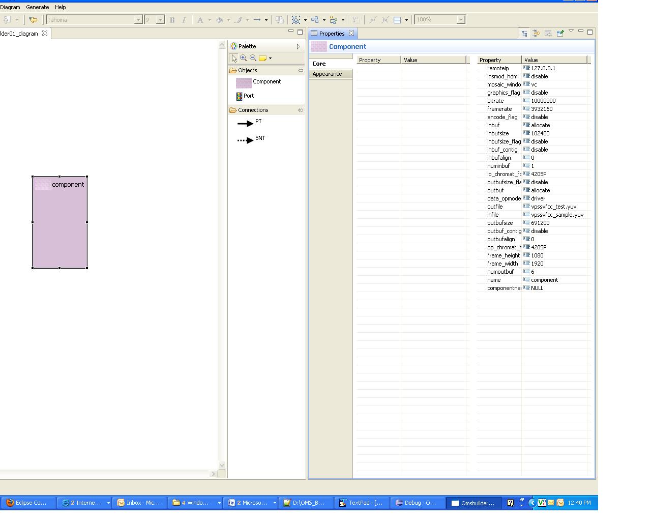

Now I am facing another small problem, that is I am getting propertysheetpage twice in my GMF editor with one having nothing in it.
How do I remove the propertysheetpage which is having nothing in it.
Please find the attached image.
Vinay
[Updated on: Tue, 13 September 2011 03:44] by Moderator

A new issue has come up....
Property window is not getting updated properly as per the node selection in GMF Editor, The generated xml file contains the same parameters for both the components depending on the final highlighted component.
Please find the attached 2 images and an xml file.
In 1st image dc node is highlighted,
In 2nd image vfdc node is highlighted but in the generated xml contains vfdc parameters even for dc node.
Can anyone help me regarding this..
Vinay
