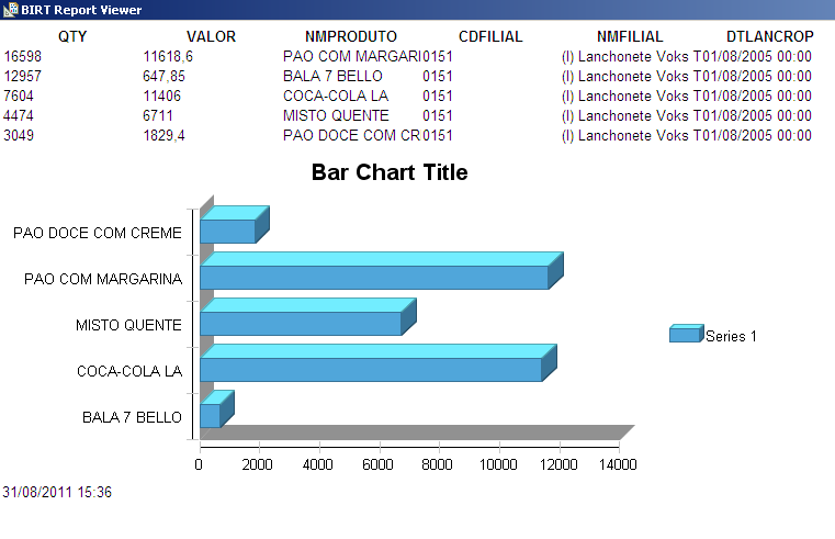

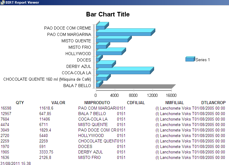

I need to display the selected data in a chart, however, something unusual happens when I try use first the data in a table followed by a chart, it works perfectly. The problem occurs when I try to use data only on the chart or the chart followed by a table.
I am using an Oracle DB.
Note:In the Sample Database Models Classic works fine.
Fernando
