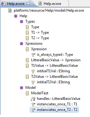

Re: OCL and strings [message #720512 is a reply to message #720472] Tue, 30 August 2011 14:21 Go to previous messageGo to next message
In fact, is_always_typed is used to handle the type.
I tried to create another example where my problem appears. I used packages. It works well when I copy paste it in a new folder.
module _'Help.ecore'
package Help : Help = 'Help'
	package Types : Types = 'Help/Types'
		abstract class Type;
		class T1 extends Type;
		class T2 extends Type;
	package Xpressions : Xpressions = 'Help/Xpressions'
		abstract class Xpression
			property is_always_typed : Types::Type[1] { ordered };
		abstract class LitteralBasicValue extends Xpression;
		class T1Value extends LitteralBasicValue
			attribute intitialT1Val : String[1] { ordered };
		class T2Value extends LitteralBasicValue
			attribute intitialT2Val : String[1] { ordered };
	package Model : Model = 'Help/Model'
		class ModelTest
			property handles : Xpressions::LitteralBasicValue[+] { ordered composes };
			property instanciates_once_T1 : Types::T1[1] { ordered composes };
			property instanciates_once_T2 : Types::T2[1] { ordered composes };
The file in attachment shows it in a graphical way (help.jpg).
Here are the steps for creating the model :
1) Create a dynamic instance of ModelTest. It will be named ModelTest.xmi, that's perfect.
2) From this dynamic instance, right click, choose new child and instanciates_once_T1. A new child will be created : T1
3) Repeat the same operation for T2.
4) Now, right click again on the ModelTest instance, choose new child and click on handles_T1_value (for instance)
5) Left click on the new value created, give it a string as an initial value, then give it a T2 type (the proposed types are T1 and T2)
6) The file help_dynamic_instance.jpg shows what we have just done
7) Here we are ! I have an instance of T1 value which field is_always_typed is set to T2. That is a problem ! For further purpose, I need to add a constraint to the LitteralBasicValues I create, in order to check :
- If I instanciate a T1 value, I want to check if its fiels is_always_typed is set to T1
- If I instanciate a T2 value, I want to check if its fiels is_always_typed is set to T2
In the OCL editor, when I am in the T1_value context, I get this :
Evaluating:
self.is_always_typed
Results:
T2
and that :
Evaluating:
self.is_always_typed.oclIsTypeOf(T2)
Results:
Unrecognized variable: (T2)
Evaluating:
self.is_always_typed.oclIsTypeOf(T1)
Results:
Unrecognized variable: (T1)
So, I can't check anything ...
If I didn't use packages, it would have worked, as I said in my previous post. But now, T2 seems to be unknown. What can I do to solve this ?
I hope it was more clear, and you could understand what I meant. Thanks for your help !
[Updated on: Tue, 30 August 2011 14:27] by Moderator
Re: OCL and strings [message #720554 is a reply to message #720512] Tue, 30 August 2011 15:45 Go to previous messageGo to next message
Providing ModelTest.xmi would have save me some time and you some
typing. A jpg is large and very limiting.
This is mad. Why force duplication when a derived property can compute
it right in the first place?
Because it doesn't work.
a) you have confused meta-levels. T1 is a type-valued expression;
is_always_typed : Types::Type[1] requires a type instance.
b) OMG OCL does not support type-valued expressions in general contexts
c) Eclipse OCL should support this but it doesn't seem to work yet
- M1 has a fix that allows Types::T1 to be persisted but
Bug 356243 provides some things for me to solve in
property is_always_typed : Classifier<Types::Type> { ordered }
derivation: Types::T1;
should work
> 8) In the OCL editor, when I am in the T1_value context, I get this :

Re: OCL and strings [message #720878 is a reply to message #720554] Wed, 31 August 2011 08:29 Go to previous messageGo to next message
I'm sorry, I should have sent the .xmi too!
Because the Xpression abstract class has other sub-classes which are not represented in my example, and I don't have any method in my metamodel. I avoid using them as I generate code...because they brought me some problems. But I've read that with OCL it was posible to specify derivated attributes. Maybe I should try this out anyway...with something like :
context Xpression::is_always_typed: Type
derive : self .is_always_typed = ??
It's not easy for me to chose the context...maybe I must ust the TxValues context in order to specify for each one a derived attribute ?
I'm sorry, I don't understand...What do you mean by type-valued expression ?
Yes, a kind of singleton instanciated only one time (T1 and T2 are those singletons)
>should work

I'm though trying to integrate it as a constraint in the metamodel, of the type :
invariant T1Constraint : self.is_always_typed.oclIsTypeOf(Types::T1);
but when trying to validate the ModelTest.xmi, I'm sent an error :
An exception occurred while delegating evaluation of the 'T1Constraint' constraint on 'T1 Value blablabla': Errors in 'self.is_always_typed.oclIsTypeOf(T1)' Unresolved property 'T1' for 'Help.ecore::Help::Types::Type' ModelTest.xmi /Help/model Unknown EMF Problem
Strange...!

So, when trying to add to my example metamodel constraints like :
invariant : self.is_always_typed.oclType()=Types::T1;
invariant : self.is_always_typed.oclIsTypeOf(Types::T1); ,
I always manage to validate the dynamic instance, I never get any error, even if I create a LitteralBasicValue T1Value which is_always_typed T2.
The constaints don't seem to be evaluated at all. I don't know what to do, maybe using classic attributes instead of eReferences...
In your opinion what should I do to solve my problem ?
