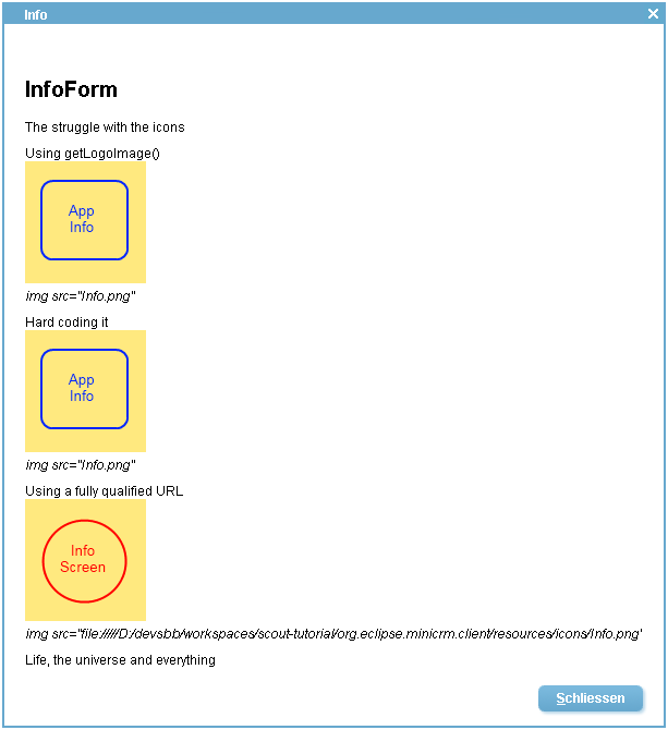

I have been looking at branding our info form. I tried the approach of extending ScoutInfoForm and displaying my own form as described in the posts by Jeremie and Stephan. I have succesfully been able to replace the text section of the info form (by overriding createHtmlBody) but any attempt at using a different image by overriding getLogoImage() have failed. It seems, that no matter what image name you supply to an <img src=""> element in the info form, it always uses application_logo_large.png from the client/resource/icons folder unless using a fully qualified file:// URL.

This results in the following output:
index.php/fa/12695/0/
As you can see, I pass "Info.png" to <img src> in the first two attempts (once using getLogoImage and once hard coded) which is the picture with the red circle. However, in both cases the picture with the blue circle (application_logo_large.png) is shown.
Only by using an explicit file:// URL to my hard drive can I manage to show the picture I really want.
Looking at ScoutInfoForm.createHtmlAttachements I see that the RemoteFile I return from getLogoImage is only used to name the file but that the content is always read from AbstractIcons.ApplicationLogo. Is this intended behaviour or a bug? In any case, apart from my problem, it seems to render the ScoutInfoForm.setLogoImage() method pretty useless.
If I understand this right, if I wanted to use a different image (or several images), I would also need to overwrite createHtmlAttachments() method. Is this assumption correct?

Re: ScoutInfoForm [message #990758 is a reply to message #990587] Fri, 14 December 2012 01:50 Go to previous messageGo to next message
Hi Urs
Yes, your assumption is correct. Attachments to an HTML field are stored in a temporary directory. Paths in the HTML code are looked up relatively to that directory - expect when you specify the full URL (as you noticed correctly).
So yes, if you want to use "my_special_filename.png" as src in an <img> tag, you have to add an attachment with that name.
Beat
Re: ScoutInfoForm [message #991047 is a reply to message #990758] Mon, 17 December 2012 02:58 Go to previous message
Hi Beat
Thanks for confirming. I have since tried this and am now able to have my own HTML field displaying several different pictures.
