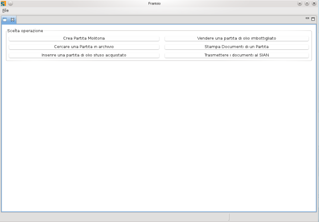

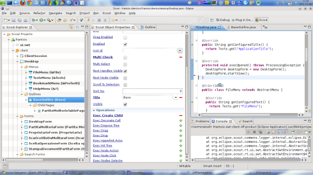

As you can see in attached images, my app has an outline with a table page, and the default menus. However, when I start the SWT application, I cannot see none of these.
I tried various combination, but nothing changed.
The only warning I see at start of the app is:
!ENTRY org.eclipse.ui 4 4 2011-08-21 12:52:19.477
!MESSAGE Referenced part does not exist yet: frantoio.ui.swt.views.TablePageView.
I updated to the last nightly update, but nothing changed.
Thanks for your help

Hi Pietro
When creating a new scout application you can choose between some application templates. It seems to me that your application was created with the template "Application with a single form". This template does not include the code for starting the forms used by outline and pages.
To change this behavior you need to add the code to startup the outline forms when opening the desktop:
protected void execOpened() throws ProcessingException {
  // outline tree
  DefaultOutlineTreeForm treeForm = new DefaultOutlineTreeForm();
  treeForm.startView();
  //outline table
  DefaultOutlineTableForm tableForm = new DefaultOutlineTableForm();
  tableForm.startView();
  if (getAvailableOutlines().length > 0) {
    setOutline(getAvailableOutlines()[0]);
This should solve your issue with the outline. To solve the issue with the menus some hand work need to be done because scout does not link the menus defined in the desktop with the eclipse menu bar so far.

Re: Cannot see outline and menu [message #717793 is a reply to message #717574] Mon, 22 August 2011 07:39 Go to previous messageGo to next message
Ok I've now solved the outline problem, following your suggestions. For the menu, I thought they should link to main bar automagically, but I know how to do with standard RCP, so don't worry about it and thanks again Smile
