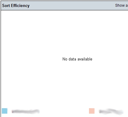

Hi Jason,
If I filter out the zeroes/null values, then the corresponding legend entry also wouldn't show up right? Customer wants to know what are the different categories that get displayed on the chart but at the same time not see zero values displayed on the chart labels. And when all are zero or null values, a mention should be made to indicate all are zeroes/null while continuing to show the label entries.
So the first example sent works very well for our case, except that now the title text is replaced. So wanted if there was any other thing that could be done to display a text apart from changing the title of the chart.
For now, we are putting the title out of the chart as a separate text so overcome the problem as in the attached image. But wanted to know if there was a way to do the other thing.
Thanks & regards,
Madhav
Re: PieChart: All zero/null values [message #721104 is a reply to message #720940] Wed, 31 August 2011 17:35 Go to previous messageGo to next message
