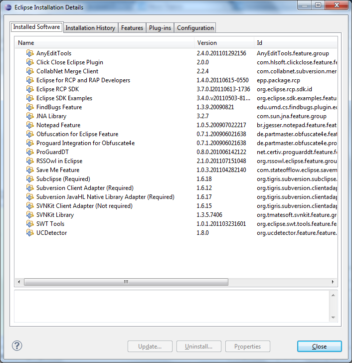

I'm using Eclipse 3.7 to develop a project and I need to do some things, using the information of installed plugins and features:
I'm using the P2 provisioning feature to allow software updates.
1: I need to get the list of plugins and features that are installed and currently running. I need something like what is displayed on the "Installed Software", which can be viewed through "Help> About> Installation Details".
Note: I will use this information to obtain data about features installed, such as version number and description.

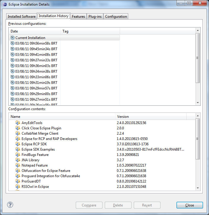

2: I need to get a list of recent installed softwares. I need something like what is displayed on the "Installation History", which can be viewed through "Help> About> Installation Details".
Note: I will use this information to add functionality to clear older installations. Something like "Keep only the last five installations."
