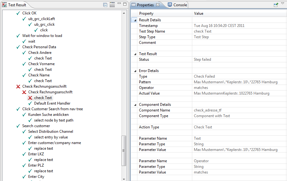

Thank you for the quick reply. In fact I have visited the exact link before I posted my problem. As far as I understand in Parameter value I should enter,
'Beispielstrasse 7\$12345 Neverland'
But when I run the test it wouldn't recognize the regexp.
I also tried the following Parameter values.
'Beispielstrasse 7\n12345 Neverland'
Beispielstrasse 7\\n12345 Neverland

Re: Check multi-line text block [message #716034 is a reply to message #716021] Tue, 16 August 2011 05:02 Go to previous messageGo to next message
Alex Schladebeck wrote on Tue, 16 August 2011 04:32
The version with the two backslashes:
works for me.
Are you using the operator "matches" for the check?
If you're still having problems with the line break, then you could use .* instead as a workaround.
Alex
Hmm.. I tried your last suggestion as well.
As you can see on the attachment, it still doesn't work. I have no idea what else I can do.
Thanks again for the quick response.

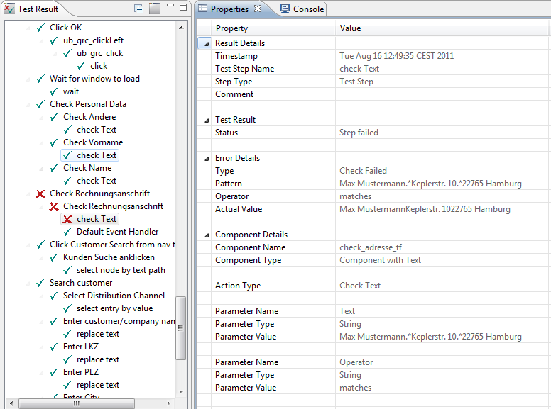

Re: Check multi-line text block [message #716051 is a reply to message #716034] Tue, 16 August 2011 06:28 Go to previous messageGo to next message
It looks like you're using backslash in front of the .* for the regex - that's not necessary. If you take away the backslash it should work.
Re: Check multi-line text block [message #716055 is a reply to message #716051] Tue, 16 August 2011 06:56 Go to previous messageGo to next message
Well, I tried that too. Sad
index.php/fa/3664/0/

Re: Check multi-line text block [message #716069 is a reply to message #716055] Tue, 16 August 2011 08:00 Go to previous messageGo to next message
It may be the case that you need to place .* after each item as well.
Max Mustermann.*Keplerstr. 10.*22765 Hamburg.*
or
Max Mustermann.*\\nKeplerstr. 10.*\\n22765 Hamburg.*
both give me correct matches in a test I did here.
[Updated on: Tue, 16 August 2011 08:00] by Moderator
Re: Check multi-line text block [message #716117 is a reply to message #716069] Tue, 16 August 2011 09:39 Go to previous message
Thank you very much for being so patient. The last suggestion did work.
