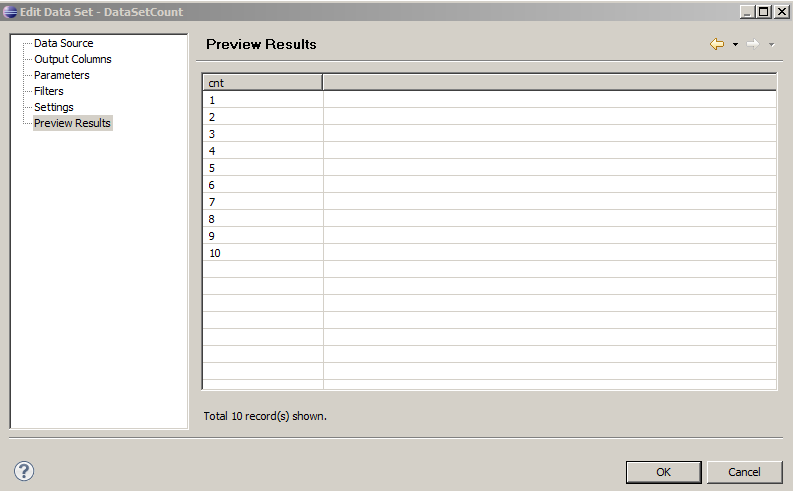

I am using scripted dataset for my report and right now I just started with a sample report where I have generated 1-10 number and want to show that on report, I have attached the report.
When I try to see the dataset preview, I can see the data in preview (see image 1.png),

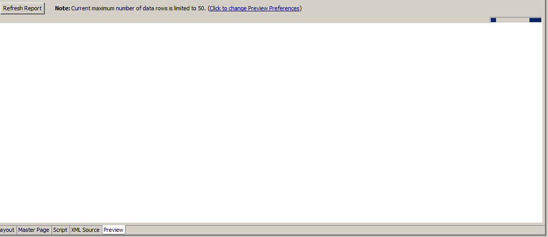

but when I use Rptdesign Preview option in eclipse I do not see anything and it keeps running infinitely (See image 2.png)

Change the data set scripts to:
open
currentCount = 0; //not using the var keyword will make it global
//to the dataset
fetch
if (currentCount < 10)
currentCount++;
row["cnt"] = currentCount;
return true;
return false;
Jason
