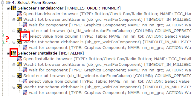

I'm a bit confused about the icons used within Jubula.
For example, some icons have a little gray or red cross
in them, what does this indicate ? (See attachment).
Is there documentation available which explains all
the icons ?
index.php/fa/3593/0/

That mean that the configuration of this thing is not complet.
Re: Meaning of icons ? [message #713895 is a reply to message #713892] Tue, 09 August 2011 06:26 Go to previous messageGo to next message
Please explain.
There are no errors and all tests run fine,
so I wouldn't know what is wrong with the configuration.
And what is the matter with that gray cross ; in my screenshot
you can see that there are two identical testcases, why does
one of them have a gray cross in its icon ?
[Updated on: Tue, 09 August 2011 06:30] by Moderator
Re: Meaning of icons ? [message #713914 is a reply to message #713880] Tue, 09 August 2011 07:18 Go to previous messageGo to next message
Try moving your mouse over one of the icons. A hover box will appear showing some details about the problem.
Achim
Re: Meaning of icons ? [message #713919 is a reply to message #713914] Tue, 09 August 2011 07:39 Go to previous messageGo to next message
The icon-tooltip only shows errors that are also in the 'Problems'-view.
I have no errors in the 'Problems'-view.
[Updated on: Tue, 09 August 2011 07:39] by Moderator
Re: Meaning of icons ? [message #714398 is a reply to message #713880] Wed, 10 August 2011 09:23 Go to previous message
Unfortunately, the red crosses you are seeing on the Test Step icons are a fault with our decorator in the current version:
https://bugs.eclipse.org/bugs/show_bug.cgi?id=340680
If there is no entry in the problem view, then your tests are fine (as you have noticed by being able to execute them).
The green cross you can see on one of the Test Cases means that there is an Excel file attached to that Test Case.
Hope that helps!
Alex
