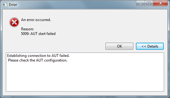

Hi guys,
I have run into similar problem of starting AUT with Firefox. It took me a while to investigate and here is the result.
I have configured the AUT as you can see in attached 'aut-conf.png'. When I start the AUT Firefox is started in the background (as you can see in task manager). However, its window never becomes visible.
After I kill the Firefox process another Firefox process is started and its window is displayed without AUT running. Jubula is still in process of starting AUT.
If I kill the java process, which is used to start the AUT in Firefox, then a warning message dialog is display (see attached 'warning.png').

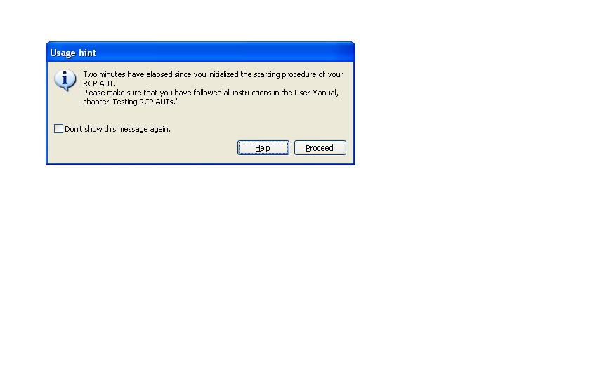

Hi!
i have the same problem starting an AUT, but in my case it is a RCP application.
My AUT Agent is also running and connected but Jubula also tells me "Starting AUT with ID:..." without any progress. Even though the application startet, i cannot see it under the running AUTs.
Therefore i cannot choose it to run my tests
After a few minutes i receive the attached warning.
Please can you help me too?

Re: Problem starting html-AUT [message #718362 is a reply to message #718186] Wed, 24 August 2011 02:11 Go to previous messageGo to next message
For the RCP problem you might want to read here: http://help.eclipse.org/indigo/topic/org.eclipse.jubula.client.ua.help/html/manual/node266.html
Alex

pskokovic wrote on Tue, 23 August 2011 08:06
Same thing here on Ubuntu Linux 11.04 (64 bit) using OpenJDK 1.6.0_22 runtime.
Once I start the AUT there are:
  • three java processes
    • one for the Jubula Standalone/ Eclipse
    • one for the AUTagent
    • and one I guess for the process that should start firefox
  • two firefox-bin processes
    • one in "Zombie" state (i.e. already terminated but parent hasn't read exit code yet)
    • one in normal state (mostly sleeping) but not visible anywhere called with the command line
      /usr/lib/firefox-6.0/firefox-bin -profile /tmp/customProfileDircb078be5cd21430eb55f9783e492a1e4 -chrome chrome://killff/content/kill.html
When I manually kill the second firefox both firefox instances terminate and another firefox instance (this time visible, but with an empty page) pops up, started with the command line
. The progress view in the Jubula GUI is still spinning and saying "Starting AUT with ID: barfoo"
When closing this new firefox instance all three java processes still exist and progress stays the same.
When killing the java "helper" process I get the error message "5009: AUT start failed" -> Details: "Establishing connection to AUT failed. Please check the AUT configuration." Progress in Jubula GUI still keeps spinning, but the terminal where I started the autagent now shows the following exception:
