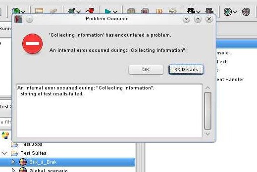

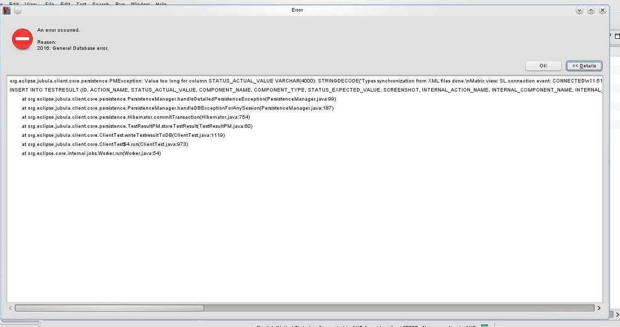

I want to check if there's a string in a text area. During the test Jubula give me two popup with a lot of error.
In attachement you can see two screenshots of the errors.
I think that it's because the textArea contains to much character, if it's the problem what can I do?
Thanks for the futur help,
Michel
