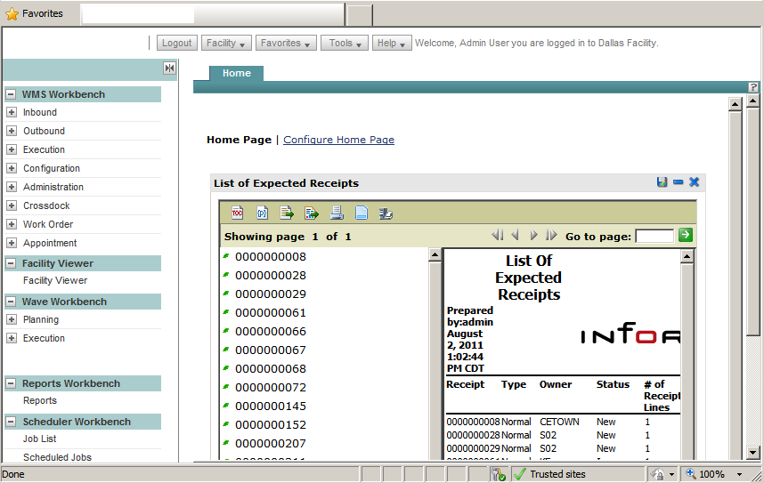

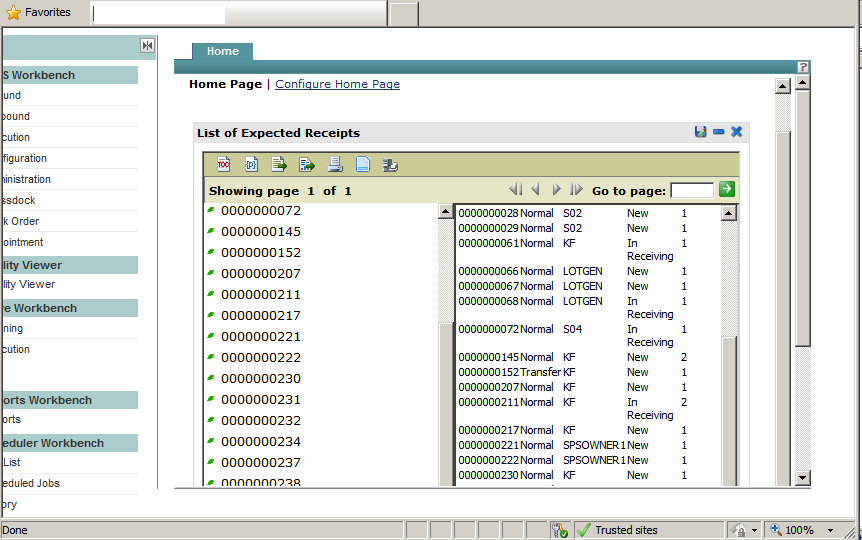

I'm using the BIRT 2.6.1 WebViewer in an application. The WebViewer is
surfaced in an iframe. When a user clicks on an entry in the Table of
Contents on a report, the entire page is repositioned with everything
shifted left and up.
I've attached 2 screenshots that shows the before and after of clicking
on an entry in the Table of Contents.
Any help or advice would be appreciated
  • Attachment: after.png
    (Size: 68.70KB, Downloaded 274 times)
  • Attachment: before.png
    (Size: 68.55KB, Downloaded 280 times)

This looks like the page containing the iframe is shifting. What does
the code look like?
Jason
