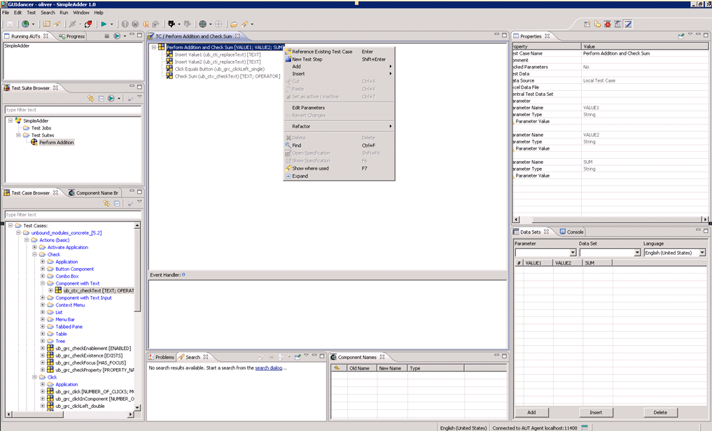

Re: Put character "=" in a textarea [message #708189 is a reply to message #708015] Tue, 02 August 2011 10:50 Go to previous messageGo to next message
Hello Michel,
it´s strange that "Edit Parameters" is disabled even when selecting the parent test case. Ususally "Edit Parameters" is enabled even when there are no parameters in the parent test case. Could you provide more information e.g. a screenshot? Typically the context menu looks like the one in the screenshot when selecting the parent test case (check attachment).
Oliver

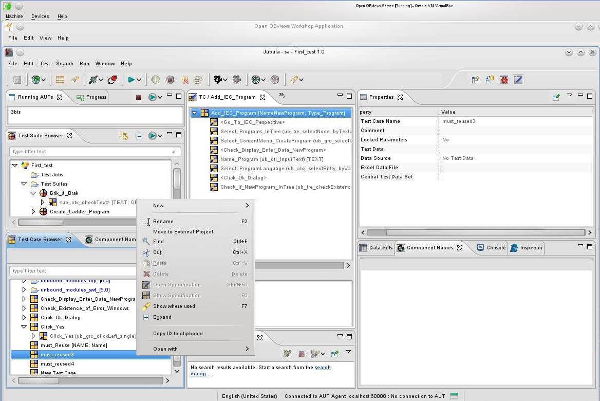

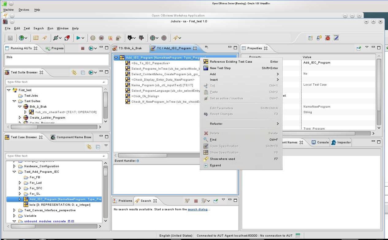

Re: Put character "=" in a textarea [message #708765 is a reply to message #708189] Wed, 03 August 2011 02:42 Go to previous messageGo to next message
Hi Oliver,
Thanks to reply.
In attachement, a screenshot where you can see that "edit parameters" is disable.
Michel
Re: Put character "=" in a textarea [message #708773 is a reply to message #708765] Wed, 03 August 2011 02:52 Go to previous messageGo to next message
I have the same problem to delete a test case in the browser, "Delete" in the context menu is disable, is it normal?
In attachement a screenshot for this thing.
Michel
