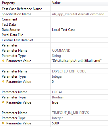

Hello, I'm trying to execute Sikuli X scripts from Jubula and have tried the external execute command.
I've made a .cmd file which executes Sikuli
java -jar D:\testtools\SikuliX\sikuli-script.jar ..\ckickTest.sikuli
It launches from commandline and does what it's supposed to do.
I've then tried to call the .cmd file from Jubula as described in the link above
I've set the properties on the command like this:
index.php/fa/4224/0/
and get this error when I execute the test:
index.php/fa/4225/0/
Two questions:
- What am I doing wrong?
- Is there a better way to do what I try to do? Wink
Re: External execute command [message #735542 is a reply to message #735384] Wed, 12 October 2011 03:01 Go to previous messageGo to next message
try to insert "D:\\sikuliscripts\\runInSikuli.cmd", this should start the external command.
Oliver
Re: External execute command [message #735546 is a reply to message #735542] Wed, 12 October 2011 03:24 Go to previous messageGo to next message
Thanks, works like a charm. Smile
